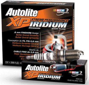

It's time for an oilchange in my SHO and my dad decided to suprise me and get spark plugs.
Autolite XP iridium Plugs-$6 a piece X 6 plugs= $36 then taxes- holy crap!
XPiridium
I didn't Pay for em, so I am putting em in!
