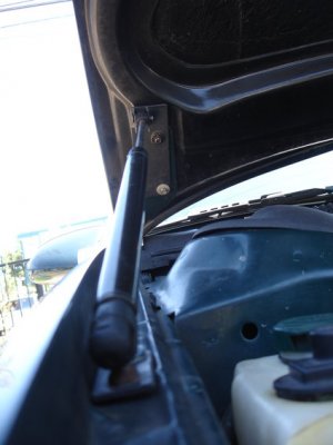

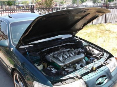

Well, fits, holds the hood up, but I wouldn't advise trying to close the hood after you install them.
Dsc09801
Dsc09803
More like a prop rod relocation, one works just fine, must be removed to close the hood. :nut:

When I put the fstb on I had to take off the struts so I added a prop rod picked up at the bone yard. It gets in the way and I would like to make up a strut rod thats less powerful than the stock ones. If I can't come up with something I'll just modify the rod and use it.
Heres the old setup that can be used with stock hoods:

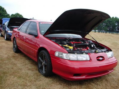

That's how Kirk does for his Cincy hood. I was thinkiing if having only one leverage point will put too much stress on the hood tho.
I didn't even notice that.. I had to check my car show pics.. :rofl:
Dsc01846
The Cincy hoods weigh in at 40lbs vs the 24lb C/F hood. Cincy is only 20lbs lighter then the stock hood, so I can see how on his car it works with just the one prop. I guess I'll continue my search!

Kirk uses his as a prop rod too, not as a strut.
Didn't know the Cincy weights 40lb, I just picked one up and it feels way lighter than the stock hood. It's not as light as the CF hood when you let me pick up Matt W's, but still pretty good.

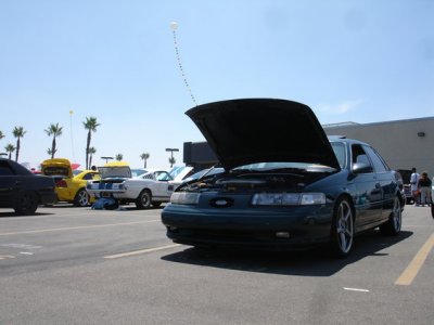

Kris, didn't realize you meant Kirk does it exactly like that. Well it's a good idea!
Anywhooo
I got to put the 'prop' to use today!! (yesterday)
Dsc19814
Dsc09810

I just went out and weighted the Cincy cowl, 26lb. :biggrin:
Dsc09810
I love this picture Matt, your car looks better and better everytime you post a pic of it. :thumb:
