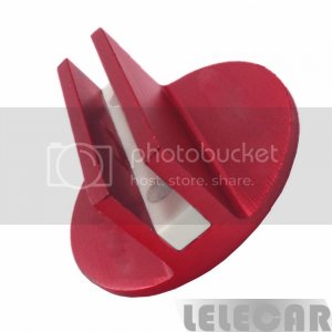

I use a Quickjack but didn't get the V-blocks for the pinch welds because of their size compared to the size of the plastic rocker moldings openings. The regular Quickjack blocks work but leave deep impressions from the pinch welds. Instead I bought these magnetic pinch weld adaptors. Saves time trying to align things up. Just slap them up there and they stay until you're done.
Ccaec372 b335 45b2 a8b6 16e99a9ae102 original
I've got a quickjack as well...good stuff. Where'd you get those magented pinch weld things? I need a set, lol
Got them on ebay over a year ago. They hold well. One day I forgot to remove them and when I got back home and pulled into the garage, I was surprised to see they were still there. Recently I didn't have one aligned all the way and bent one. I quit using them as the quickjack blocks don't seem to sustain any damage from the pinchwelds.
