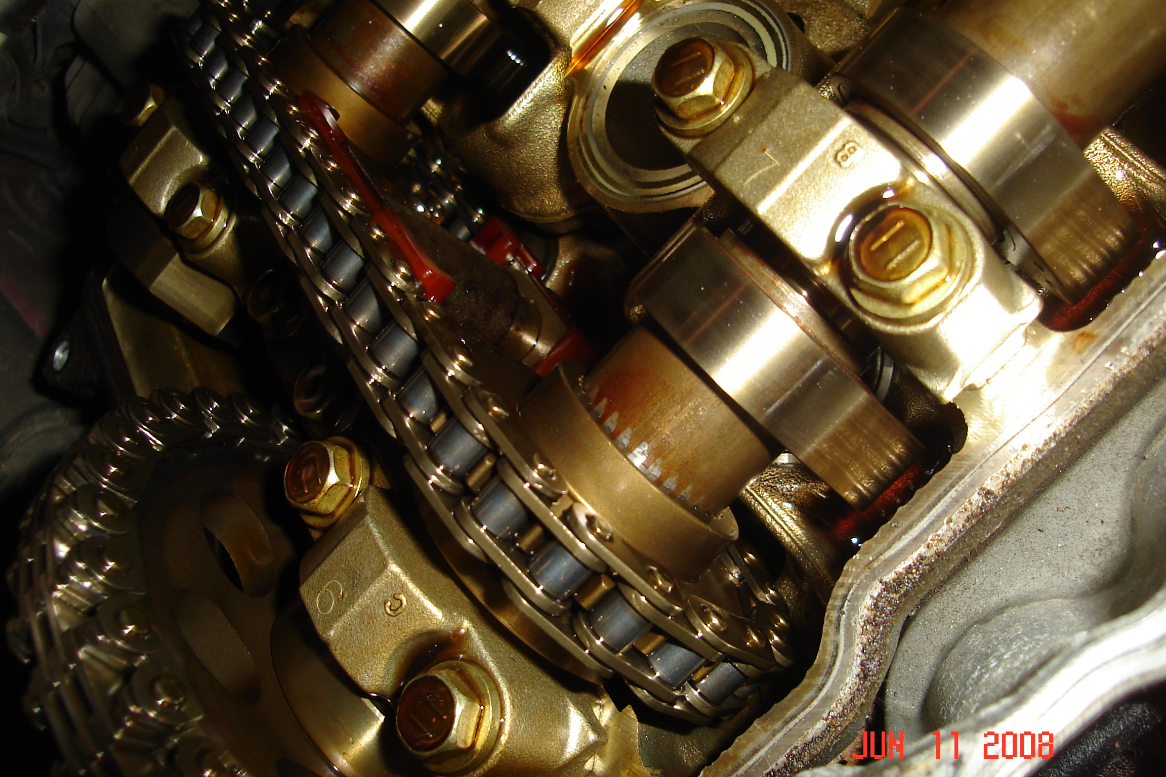

So, per my photo: http://www.pinnacleofdestruction.net/cams/Rear_Top.JPG
Isn't that suppose to move back into it's original location rather easily?
Post a picture from the other side of the sprocket. It looks like it may have been mis-located originally and may not need to be moved at all.
Also, you will need to remove the slave tensioner from the head to release tension off the sprocket to be able to move it.

Other side... hmmm so if you're in front of the car, the left side or the right?
The picture of the sprocket you posted, take a picture of the other side of that same exact sprocket. The side facing the front of the motor.
