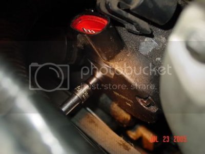

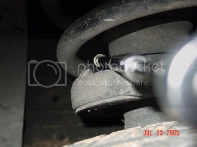

p.s., i had no problem replacing the sensor from under the hood, with my intake off (some1 showd pics of going through the wheel well), i dont know how much clearences differ between MTX and ATX though (mins ATX)
