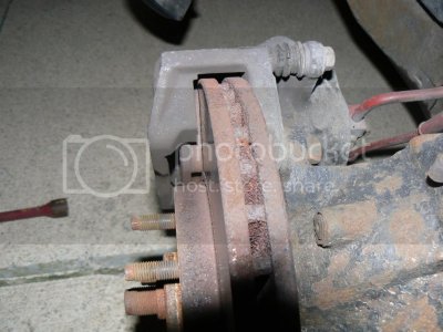

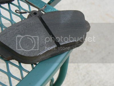

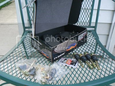

Sorry it took me so long to get this pic up.. was kinda busy.. but here are my PCFM's after 20K pretty hard miles... not crazy, and no track time, but anyway.. here's what I have left.

and a shot of them new...
P1020199
Hard to tell how thick there.. but this last one is a pic about 500 miles after I "bed" them.. they were catching the lower part of the rotor... but after reinstalling them I never heard from them again..
P1020204
Didn't really lose any material off them... I'm thinking I'll replace the pins, and caliper before I change the pads again..
