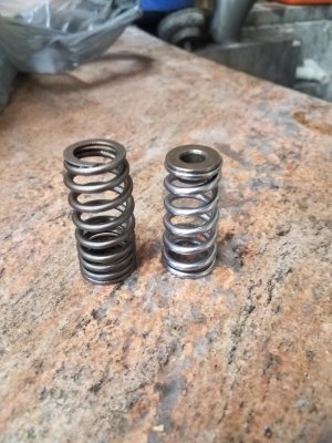

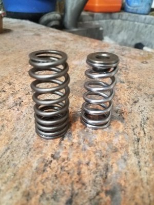

Received these pics and info from machine shop today. Factory/OEM on the left. Upgraded on the right.
"The new valve springs have arrived with a seat pressure of 67 ftlbs and open pressure of 140 ftlbs. Factory spring pressure was 51 ftlbs seat and 95 ftlbs open. The added spring pressure is too aid in the added boost pressure on the back side of the valve's and also for the slight added weight with the oversized valves. Too guarantee it will never have valve float." ----shop owner8b85d0419ddf43ff10ae74816c026cc0D6b5f32377d96f6bc70b9a8bb4a235f2

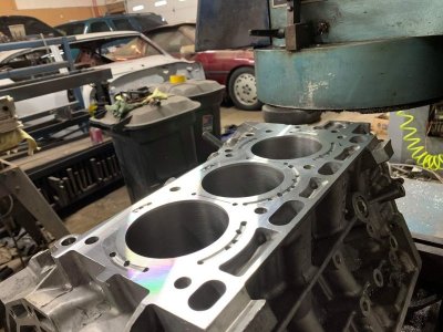

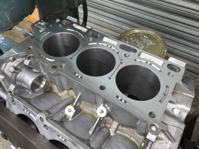

Recv'd some pics from the engine builder/machine shop owner today.
Block has been milled/polished and have been told that the short block portion of the re-assembly should be on track to begin by week's end, or by next week sometime.
Couple of pics of that, as well as a little something something lurking inside that cardboard container.

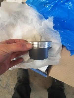

03/03/2020......

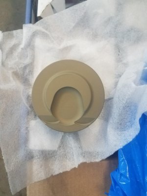

Pistons have returned from company that performed the coating(s) on them. Looks sharp.

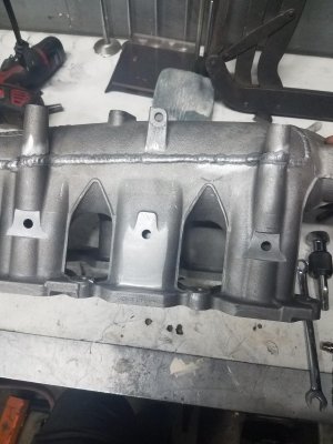

And for those wondering what was in the boxxxxxxx from Pro-Meth. Yes! A multiport/direct port kit from them.
My engine builder has begun the necessary work on milling, welding bungs on, and also bending supply lines. Off to the PC'er for powder coat/thermal coating, then to finish up on that next.
