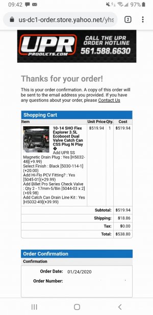

Dang. I've been looking at catch cans for my v8 coyote f150 but $500? Post back with how you like it

Mind you, it started out at like $350.
But that was the basic kit. Which seems on par for most other competing products.
I chose to buy in on all the available upgrades offered, which brought the price up to where it is shown at completion of sale.

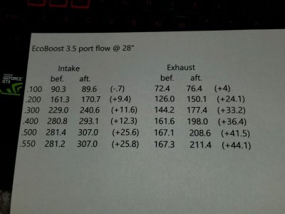

Placed an email inquiry to x35 Designs, in regards to their new product offering (Phenolic Spacers) and expressed willingness to pay in full immediately, to facilitate a quick turn around.
Also, received data from the machine shop owner this morning regarding flow data on BOTH the Intake, and the Exhaust ports, for all of the extreme custom porting work that has been performed on my heads.
The data displays 'BEFORE' and 'AFTER' #'s for public consumption. I have been told this improvement (a nearly 26% increase on the intake side, and 44% increase on the exhaust side) is projected to provide an 80 to 85hp improvement on just this one modification alone.
Getting more excited as the clarity and culmination of several months worth of work, is beginning to show HUGE improvements in many areas.

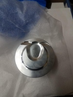

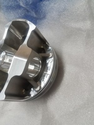

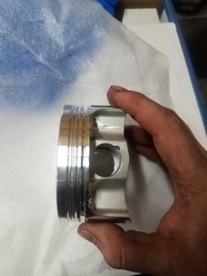

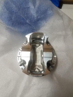

02/10/2020.......
Thank you to all who have provided suggestions regarding cams.
I have consulted with (and have passed along the info to) my builder, who replied that he will research and crunch #'s so to speak, to potentially make use of whatever is best for my application specifically.
Pistons have been completed and pics provided earlier today. Chugging along on the train of progress!
