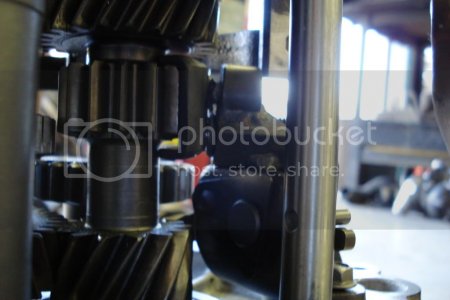

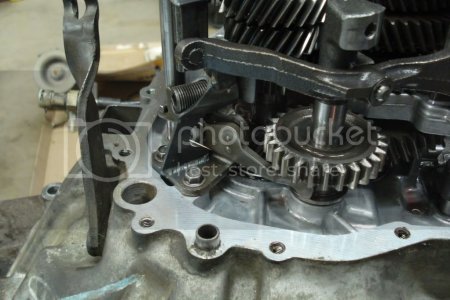

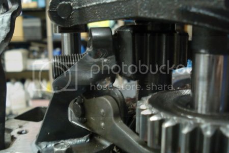

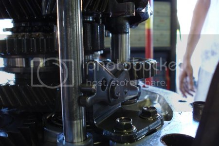

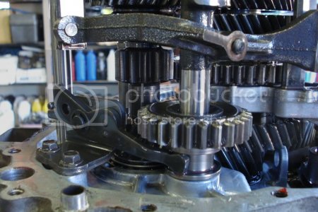

Thought I'd add a few pictures of my MTX input shaft reinforcement modification. Thought I had lost these pics...
It seems to work when properly adjusted. I had 2 failures that occured when the piece was out of proper adjustment.
Here is the stock reverse fulcrum bracket
TransMod001
TransMod003
Here is the modified version. It uses the same bracket but houses an adjustable shaft snubber. This reduces shaft flex at the weakest point.
The other case half is drilled out and plugged so you can adjust it. The threaded hex stud threads into the housing and moves the collar out against the shaft.
It seems to take about 1/4 turn adjustment every 1K miles or so depending on how it's driven. The threads have a small amount of lock-tite to keep it from backing out due to vibration. This was developed by an engineer/machinist and myself.
