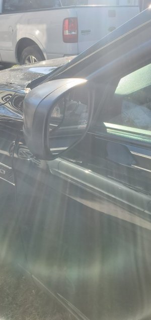

After trip to the junkyard I scored some spotter mirror style mirrors with chrome caps. They have heat so all that is missing is BLIS and auto dim(which is what started this problem and i dont care about having anyway).
The MKS they had was destroyed so no go on if those fit.
Pulled the caps and dipped/sprayed them matte black to match the rest of my vinyl and I have found the BLIS wires in the harness. Next step is sourcing some small LEDs to mount in the sail panel for blis indicators. I'll post pics later so this can be an option for anyone in the future.

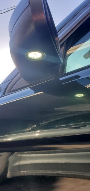

They're installed. I also replaced the puddle lights while i was at it. For the mirrors, puddle lights, and eventual BLIS relocated indicators im into this for about $70. Little better than the $400+ Ford replacement and no chance the autodim will corrode againe.
I'm not a fan of the dipped covers though. Think I'll eventually swap to the glossy ones, while not textured they look very base model to me, plus I got a massive run in both I only noticed on my 6th coat. Pics of relocated BLIS indicaters coming soon.
The system DOES notice the indicators are not connected, I started getting blind spot system fault and cross traffic fault messages. So anyone that swaps the mirrors if you don't replace with BLIS mirrors it appears you will have to either disable it with forscan or relocated the indicators.
