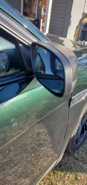

They're installed. I also replaced the puddle lights while i was at it. For the mirrors, puddle lights, and eventual BLIS relocated indicators im into this for about $70. Little better than the $400+ Ford replacement and no chance the autodim will corrode againe.
I'm not a fan of the dipped covers though. Think I'll eventually swap to the glossy ones, while not textured they look very base model to me, plus I got a massive run in both I only noticed on my 6th coat. Pics of relocated BLIS indicaters coming soon.
The system DOES notice the indicators are not connected, I started getting blind spot system fault and cross traffic fault messages. So anyone that swaps the mirrors if you don't replace with BLIS mirrors it appears you will have to either disable it with forscan or relocated the indicators.

I like the dip look, plain is my mode.
I love it, Stealth mode, my wife's fusion is almost completely dipped. But the dip on the mirrors almost matches the shade of black on the plastic exactly. I'm still torn, might peel the dip off and sand the caps down and take my time with it see how it comes out then. Stupid as it may sound I realized there was a back, center, and front glossy section (rear quarter trim piece is gloss in the center, b pillars are glossy, and the mirror cap was glossy) so it kind of tied everything together. I'm driving myself nuts with the details.
