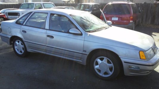

Ok, so blinkers work fine while headlights are off. When headlights are on the corner blinkers do not work. Any ideas as to what might be causing this on a 89 SHO or is this normal?

Are you talking about the one integrated on the headlights or the side bumper cover?

The side marker light I be lieve are only on when the headlights are on. The corner blinker is what I am referring to.

If I'm understanding correctly which light isn't working (an actually blinking turn signal rather than the cornering light that stays on while the turn signal is operating), the symptoms sound very characteristic of a bad ground. When the headlights are off the ground connection is made through the headlight and associated wiring, but when the headlight is energized there is no longer a path to ground potential.

I wish I had easy access to my car but it is parked far away from where I live currently. If I am getting this right, you are referring to the orangish corner of the assembly? If it is supposed to flash and it's having difficulty my first thoughts would be the light switch with the integrated dimmer has always been a problem area for shorts and such.
