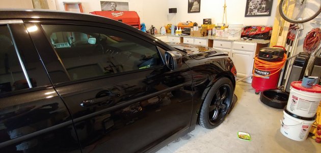

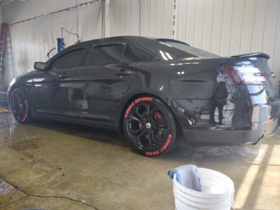

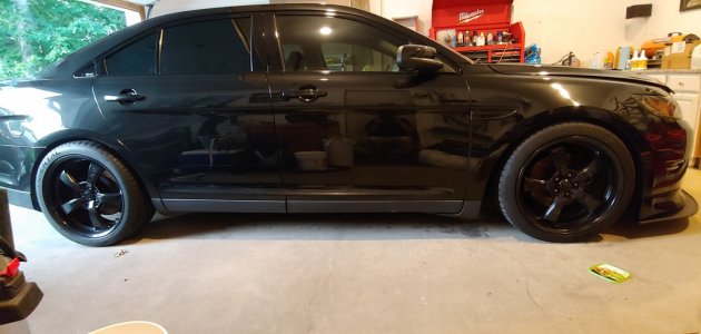

Check out these two threads of mine for ideas
Had my trim wrapped for about a year now, through a Michigan winter and washes and it's held up like new so far. Haven't had to mess with it at all. (yet). I'd say do it right the first time and you won't have to touch it.

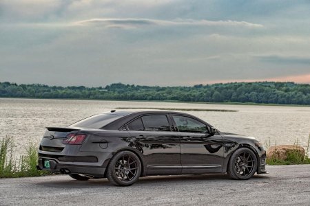

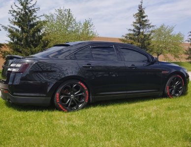

Definitely use quality vinyl. Years ago I had used some CF vinyl from Auto Zone and a little after a year it started to flake off in some spots…as if it became dry and brittle.
When I did it over again a couple years ago it was with gloss black vinyl from Vvid Vinyl. It’s held up great, although the car doesn’t see snow or salt since early 2018. F4EB8602 414D 405F 9BBB E2E53C21174F6419BBA9 4663 45E0 A6F8 19E7B0BA5DE9793BD58E 3F03 48D5 8969 342C872CA332F4EB8602 414D 405F 9BBB E2E53C21174FACFEB45B 5D07 43D1 991E 8F7987CEC28E
