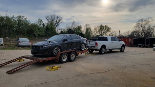

Slow and steady wins the race. Figure the race is just me against @802SHO at this point. Only person with a sho more built at this point. I've got some tricks up my sleeve and our battle will be epic at this rate.
Car is getting ready for launch tunes and I've got spare parts locked and loaded as I need them.
