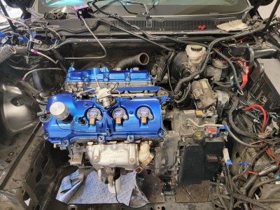

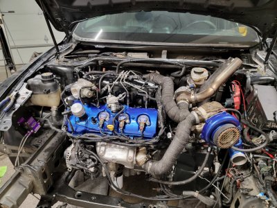

For rattle can, it looks pretty darn good.
Glad to see some Ford blue back under these hoods too. Might borrow your idea, just for aesthetics. Is your intake painted or coated? Being black it helps the blue stand out.

Doing a little bit of improving. Used transmission going in with gearhead Torque Converter. Actually going to reseal some things on the engine and check out everything while I'm in there. Got a tiny front cover leak. Going to fix up the rats nest and probably cerakote some things to make it pretty. Going to probably take a month and just really take my time with it! What you're seeing is about two hours of work!
It's just black engine enamel

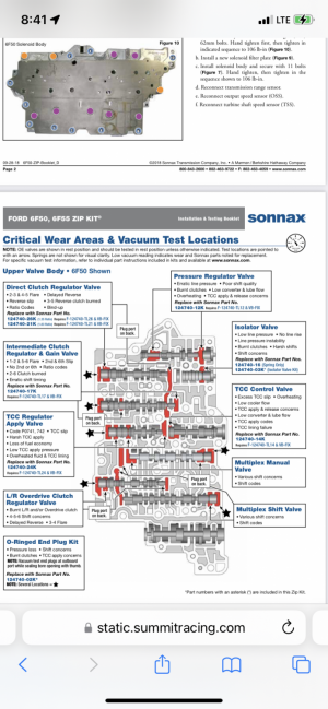

Here you can see all of the issues coming from the valve body…and most of them lead to burnt clutches too. 816CD059 354D 46EB 85D2 779AD3F6605C
What we need is an upgraded valve body, and from a quick search I found this. I think I’m going to contact the company and get some more info. Swapping out the valve body can be done with the trans in the engine bay. https://www.ebay.com/itm/303514324476

So as I’m looking at it….seems like there’s a lot wrong with our valve body….to the point of like..wouldn’t it be some shit if really all we mostly need to focus on is upgrading it? Just the valve body? We burn up the clutches and think we need better clutches. How many valve body flaws from the factory lead to burnt clutches? Maybe we don’t even know how good our clutches are bc the design flaws of the valve body ruins them. Are we focusing on the wrong thing? Very interesting to see how many areas of concern there are in the above diagram.
Edit: pretend the diagram of the valve body is a school test, all the wrong answers are marked in red. That’s an absolute failure son! Our valve body is 100% the culprit
