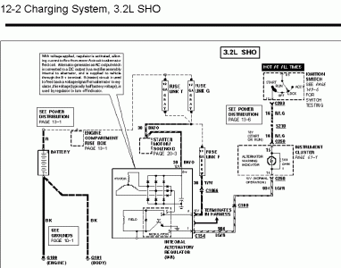

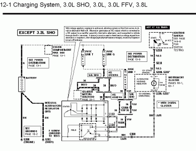

As far as I'm concerned running a power wire UNDER the car is a no-no. What if you bottom out on a speed bump or something and it cuts or scrapes into the cable... The cleanest way to tap into the power is at the fuse block in the engine bay, to the right of the master cylinder. Just undo the nut, connect your power and put the nut back on. This way you don't have a 2 or 4 gauge cable running through your engine bay. A bonus is you have less cable to buy! Couldn't be more simple.
