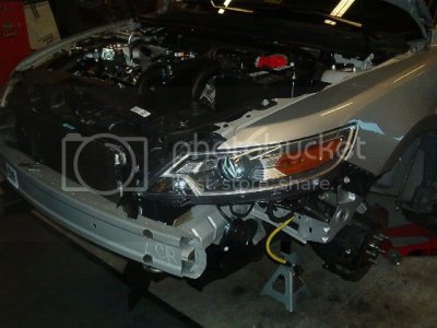

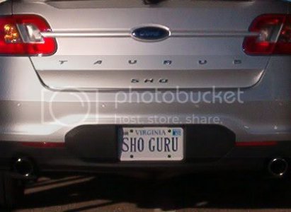

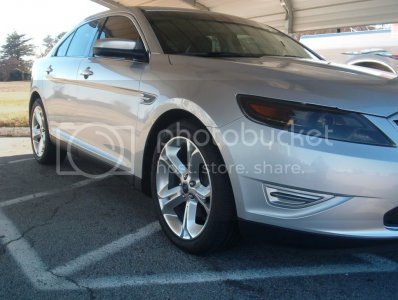

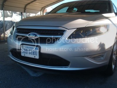

Kirk was the first to tear into his front end, then I followed. We both had our chrome painted and he did the window chrome delete and I redesigned the back trunk lid with the "Taurus" and "SHO" lettering while deleting the Ecoboost badge. The side vents, rear sphere on the trunk and all front chrome are gone on mine, plus I tinted the headlights. Here are some of my pics from before.

I love the rear deck lid, I'm starting to like the chrome on my platinum white more and more. The other colors not as much, except maybe black.

SHO U Up, looks great! Thanks for the pictures, what type of paint did you use, wonder about those pesky bugs that plaster the front of our cars.....Have to really scrub them off sometimes...

My car doesn't see alot of night time driving so my bug issue is kept to a minimum. Rocks are my enemy though. :laugh_ti: I do have some chips here and there now which aggravates me 'cos Ford said the car had this special paint to help reduce chips. Looks to me it will resemble the rest of my car's front ends over time. I would advise the new guys to look into the clear material for the bumpers/hoods for sure! And the paint I had my body shop guy mix for me. Sure beats going to buy that stuff from Ford or a paint shop.
