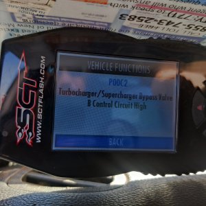

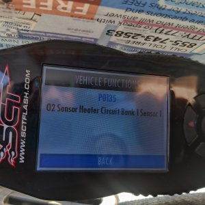

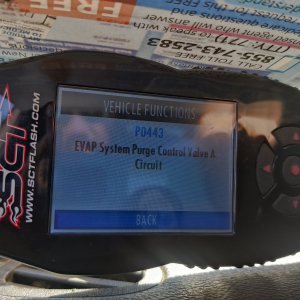

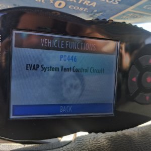

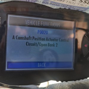

Theses are all check engine lights I'm currently getting, if I clear the codes and start the car I don't get a check engine light while I'm driving... As soon as I turn the motor off and go to turn it back on the CEL Comes back on until it's cleared, I'm hoping someone on here has had the same problem, thanks in advance all

Start by checking fuse 67 and/or 70 in the battery junction box
You sirs are a genius it was fuse 67, its crazy ive never seen a fuse do this but it burnt the middle section out but there was just a tiny piece holding on for dear life which is why i think once the car was running it was ok.... i popped a 20 fuse in and all my lights are gone thank you again STRIPSHO
