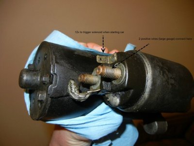

That wire with the orange tape on it? That goes to the starter. It's what triggers the solenoid to actually send power to the starter to crank the car over. It goes on a little tab near the two studs (bolts as you say) on the starter.
The car will never crank without it connected.
:facedesk:
It's the wire I was referring to checking to see if it had 12v when someone is trying to crank the car.

So your wire with orange tape should go to that little tab labeled 12v to trigger solenoid. Then there should be two positive wires that connect to the one stud labelled as such.

Oh man. I got a guy to check it out for $40 but I gave him $50 instead. It started when he connected the orange wire to the bolt. (stud as you say lol). It fired up. But when he looked by my clutch switxh, he tested the orangish wire and white wire. He told me neither of the wires were hot. He grabbed a random wire laying around and attached them so that way the car starts up. He said it will be a lot less expensive to just do a push start instead of replacing everything.
