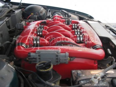

some pics..

thanks josh for the advice, i sanded down one of the brackets you mentioned...threw it back on, and she fired almost instantly...
unfortunately, now theres a huge vaccum leak somewhere...it makes an ungodly whine if revved just off idle, then wants to stall...
EDIT, yea, in that pic above, i had removed it before taking the pic to start sanding on it...it seems it was the culprit..since now that the parts it attaches to are bare metal...the car started up
