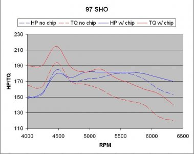

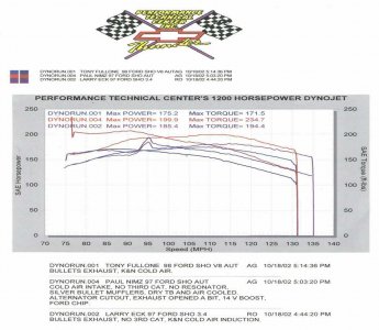

For those of you who were wondering, Showhat9 dynoed his car stock, and then with my chip. He has both graphs, so I will let him post those, or if someone wants to host them, or wants to see them, I will be happy to e-mail a copy.
Now one graph was in MPH and the other in RPM...this is the way they were printed at the dyno for him. I went ahead and converted each MPH point to RPM, and then properly compared the graphs together, for all points they have in common (they were not started/ended at the same points). This is why you have such arbitrary RPM points. I also used excel to plot them together to show the gains, and he has that too, so he can post them, or I can e-mail it to someone.

Here are the gains at the following RPM points.
RPM HP TQ
3995 -2 25
4230 2 27
4465 -5 21
4700 5 18
4935 9 16
5170 7 26
5405 2 25
5640 2 23
5875 7 20
6110 15 29
6345 17 20

How can you gain Torque and lose HP? Given the equation HP = TQ*RPM / 5252, if you increase torque at a given RPM, you increase horsepower as well.
The dyno's were done 2yrs apart. It is not uncommon to see plus or minus 5hp/5rwtq on different dyno's or different days. The only two places where it lost, it was 5 or less, so I'd say this is to be taken into account on the error. You can dyno the same cfar on seprate days and show stuffliek this...what you need to look at is teh oevrall trend. On avg, he gained liek 25ft/lbs everywhere and maybe gained a couple of HP at most places.
The SHO has mostly all the timing it needs form teh factory for max HP, but there are, as you can see, palces to improve the orque and to keep teh HP up for longer nthe hgih end.
Also, the actual points where this happend, is where the stock TC "flashes" as it locks. This skews the retulst athe this "peak". This is revised on my chip, so it would not show flash to such an extent. You can see what I mean in the graphs. I think this is another plausible explanation.

I can understand Dyno variations, but what I'm saying is that it is impossible to gain torque and lose horsepower at the same RPM, because Horsepower is a Function of Torque @ RPM. If the RPM stays the same and the torque increases, the HP also increases.
For instance, lets use the 3995 RPM point:
Lets say (since I havent seen the chart yet) that the car was making 180 Ft Ibs of torque at that RPM before your chip.
HP = TQ(180)*RPM(3995) / 5252 = 136.9 HP
Now, lets add in the 25 Ft Ibs of torque gained:
HP = TQ(205)*RPM(3995) / 5252 = 155.9 HP
As you can see, there cannot be an improvement in TQ without a corresponding improvement in HP at the same RPM.

I understand what you are saying. However, this is what the graphs show...I just went by what they showed... They should be posted soon.
Now when you look at the graph...you san see it on the "before." It is at the peak, and the numbers at the top show "194tq" but when you run the numbers at this point, which is the 4465RPM point (95MPH) you get 165HP. But clearly, the graph shows there like 185Hp, so beats me...
The important thing is too look at the trend...I think the gains are impressive for just a chip, on a stock car. That is A LOT of torque to pickup, and the best thing is, he picked it up in the entire RPM band. These SHO's need justy that, torque. The graphs also show how HP is kept up longer at the higher RPMs..

Here is the b4:
97shob4
here is the after:
97shoaft
Now one of these, as I said and as you can sse, was done im MPH and one was in RPM. I went ahead and converted the MPH to RPM by figuring out what RPM he would be at for each MPH point and graphed them together to see them side by side here:
97shocomparison
