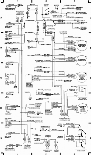

So i was curious if the Alternator Output Control Relay is the same for both the 89 and 90?
I attached snapshot of the 89 and 90 EVTM regarding this item but it is not clear if it the same part number.
I am rewiring my 89 with a 90 harness and i think i forgot to pull this item. Thoughts?

Pic 1 is for a 2.5l engine, not a SHO. The component diagram is for a SHO which shows an alternator output control relay, but it actually doesn't exist.

No, im swapping a 90 harness into my frankenstien 89 SHO. The dash is a 90 and a long time ago in a state far far away i created an adapter using donor harneses to adapt the 90 dash harness to a 89 engine bay harness. i couldn't get the gauges to work. I figured its faster to just swap the harness. But i could be wrong. LOL
