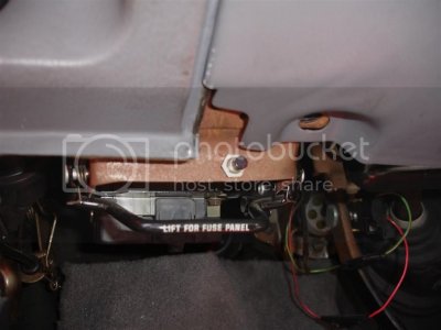

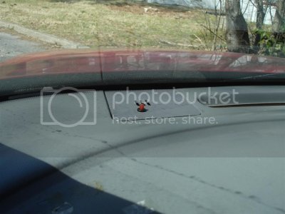

Mine has an alarm on it, and I think it's stock or dealer installed, as it's got Ford stickers all over it. There is a button you have to push... on my car, it's right above the handle you pull to get to the interior fuse panel. Is there a blinking red button next to your autolamp sensor way up there on the dash? Is it blinking constantly? If it is, that means the system is tripped and you'll have to find and push taht button before you can start it. After you get it started, hit the blinking red light until it only blinks twice at a time... that means it's off. I hope this helps.

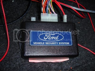

Found in the trunk next to the RKEM:

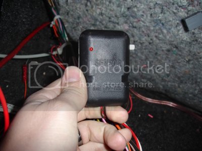

The shock sensor, also next to the RKEM:

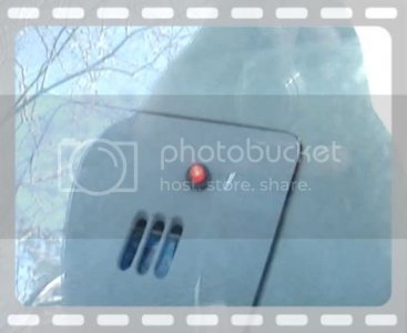

The blinky red light:

The button you have to push to get it to start:

A short movie of the blinkage:

Yeah, those pictures were in response to a thread claiming there was no such thing as a factory alarm system.
Anyhoo, you arm/dearm the system via the blinking red light. To disarm the system after it's been triggered, you press the little black button that doesn't blink.
