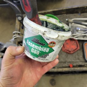

Radio bezel, arm rest bezel, Drop knee kick, drop steering column, pull cluster, swivel 8mm and some trans assembly ****(to dip the socket in the catch the screw).
