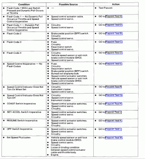

So one other thing is puzzling me...When I performed the static CC flash test, the green "CRUISE" light flashed 4 times. Would a faulty brake pedal switch give this static error code? I think I remember seeing the first result is "Circuitry" and the second entry is ABS Control Module. Would this faulty brake pedal switch qualify as "circuitry?"

Where did you find that ? (I searched in the Ford book and seems not there.)
It's seems that the brake switch will throw a flash code 2 ("brake pedal position BPP switch"). Are you sure isn't 2 codes #2 ? ;) Code #4 is pointing mostly at ABS module... "Circuitry" and "speed control servo" appears always together in each cases, it's probably ABS module internals.
