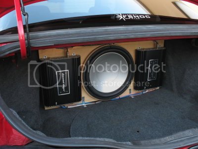

3. My amps are mounted on my sub box.

3: I have 2 amps also. 1, 1200.1 jbl amp on the passenger side seat and the other one... well see my pics up the page a bit. You could also just attach it to the back of the box if its big enough (the sub amp that is).
