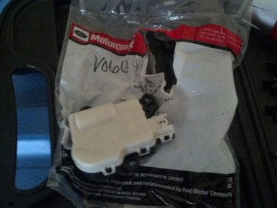

The Part: Door blend actuator (part number: AA5Z-19E616-C) . I got mine on ebay for $19.00 shipped. It is a genuine Motocraft part. Here is the link to the part and a photo I took of the part.

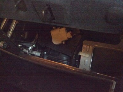

Fully release your glove box door so it "hangs" down. There are two clips/bumper stops on the right and left side, towards the rear of the glove box interior that need to be removed to do this. It is the identical first step you take when changing the in-cabin air filter. Once the door drops, you will see this:
CLA2mSBh
You will clearly see the white part. There are 2 clearly visible hexagon head screws holding it in. Remove them. Then, undo the electrical clip fastener. The part will now be free from the car.

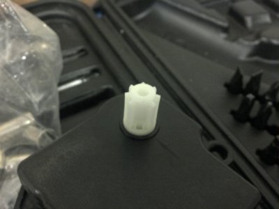

In my case, the gear shaft was not properly lined up. You will note from the photo below, there is a small flat area on the gear shaft - it is not perfectly symmetrical, so it can only go in one way. If it does not line up, start the car and fiddle with the temperature control (hot/cold) , as that will turn the gear shaft clockwise and counter clockwise. Play with it until it is in the right position to insert with the 2 hex head screws lining up. This is very easy, but takes a minute or two to fiddle with to line it up. See non-symmetrical gear shaft below - the "flat" area is facing you.

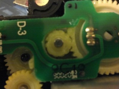

I opened up the broken actuator and the photo is below. You can see some inner gears are work down and broken in the center of the photograph.
