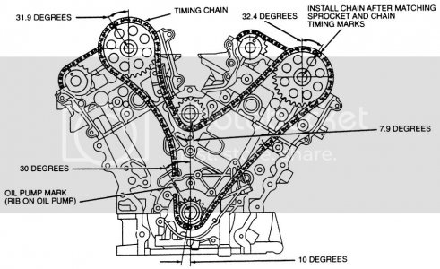

Use this link as a guide to compare if your cam(s) are spun, any one of them may be bad.
http://www.v8sho.com/SHO/CamSprocketAlignment.htm

Cam Indexing:
