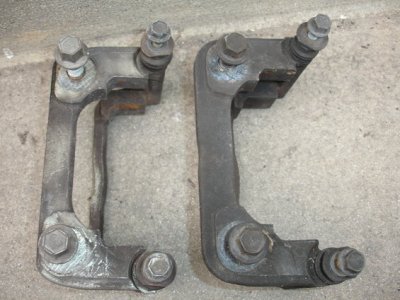

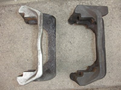

The Brackets found on the Mark VIIIs are not FN74s, however they will still work.
Compare for yourself. The only difference is the extra nub.
Dsc07271
Dsc07272
Dsc07273
Dsc07274
As far as bolts go, if you pull brackets off an '01+ leave the bolts, they're too long!!!

Is it me, or does the brake dust make the Mark VIII brackets look a little "beefier" in the second and third images?
[images deleted]
Dsc07271
Dsc07273
you are hereby bequithed the Clara Peller award.:thumb:
as for the bolts, they are the same front and rear, so just get some more rear bolts to use on the front, or cut the ones that are too long

I've also recently seen the Mark VIII-type brackets on 1996-97 Cougars and one Thunderbird.
The rotors in each case measured 11-19/32s (ie. 11.6").
Dsc07271
[deleted x2]
Dsc07274
