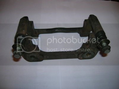

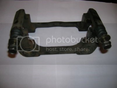

Let me dig in my photobucket for a picture of a FN74 stamping
NikonPhotos108
NikonPhotos107
NikonPhotos106
NikonPhotos105
See if that helps. My monitor at work is too dark and I can't tell, but those are my old FN74 brackets I sold to some SHO owner on the east coast 2 years ago.
