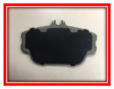

Get your brake pads replaced, and possibly rotors if they have been damaged, plus labor.
Bosch "Four tab" shims used on 598 size brake pads manufactured between Oct 2014 and Oct 2015 may slip off and cause danger or damage.
Affected pad design:
U14hW6v

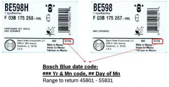

Attachment A to this letter contains photos of the affected brake pads (subject to recall)
and photos of unaffected brake pads. Also included in Attachment A is a photo of a
representative label provided with the brake pad along with the affected date codes that
you may be able to use to determine whether a brake pad you purchased is subject to
this recall
What is the Problem?
Under certain conditions, the shim on the subject brake pads can shift out of the original
position and can come into contact with and cut a groove in the rotor. If the shim
contacts the "hat" area of the rotor and the condition remains undetected for an extended
period of time, the rotor could eventually break, resulting in a loss of brake function at
that wheel end. A loss of brake function at a wheel may cause an increase in vehicle
stopping distance, thereby increasing the risk of a vehicle crash. Noise associated with
the shim contacting the rotor during braking should provide advance warning to the
driver of this condition.

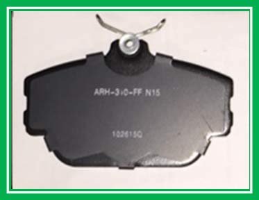

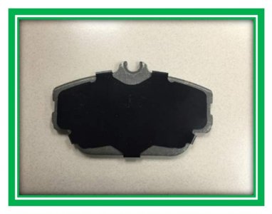

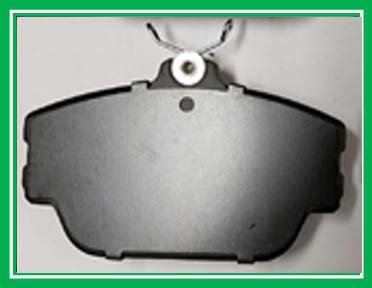

Non-affected pad designs:
C5HBmNsU7Cpxfd NGG0fND
Affected Lot/Date codes on packaging:
UMoYnHx
