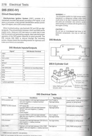

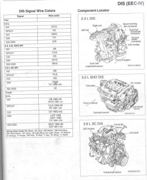

As you can no longer pull codes and they weren't present on the new ECM, and the old one that may have codes is no longer in your possession, you are back to basics. That is checking for spark and fuel. Seems like you have fuel, so buy one of these to check for spark:
If no spark, test the DIS Module for everything else:
DIS Test P1DIS Test P2
