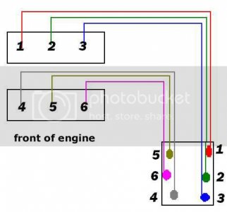

Have you done a compression test on that cylinder?
Also it might be worth a try cleaning the threads, sometimes if anti-seize haze been used it can cause crappy conductivity to the spark plug.

no codes yet, which sucks because a CEL would help at this point, compression test checked out just fine... thank you for the diagram ill double check that, and i hope dielectric grease was used and not antiseize but thats worth a double check too.

Another test you could do to determine where the problem lies is switch wires one and four (I believe they fire at the same time) and see if the problem moves or not. If not that would eliminate anything upstream from the ignition wires.
