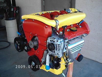

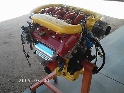

I've managed to squeeze in some time to get the engine in its semi-final form. Purty eh? :omgsho:
Post 1191 1241407062
Post 1191 1241407077
With the engine harness and intake manifold on, the remaining items are minor in comparison. However, with a pending move to southern Arizona in the next six weeks, its not likely that I will get much more done until after that.

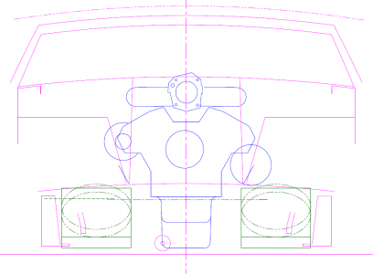

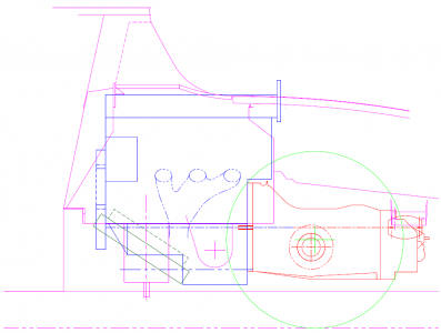

I Spent some time working on the first mockup for the mini-radiators. These are 11x14.38x2" dual-core, with fans mounted on the back side. In this configuration they would mount on the engine bar with a floating frame. This way the engine and radiators would be removed together when dropping the engine out for service.
Post 1191 1320895874
From the side you can see that the exhaust will drop down near the back third of the radiator. The exhaust manifold has heat shields added to it since on the stock config one manifold is less than an inch from the radiator fan.
Post 1191 1320895890
From the back, the radiators will sit just inside the motor mount frame with plenty of clearance for exhaust pipes.
I'm beginning to like this approach, especially if I can tie them to the motor mount bar. I would replace the caps on these with a fitting to connect to either a single or two separate fill bottles that would be mounted high near the engine lid. It should make getting air out of the system much easier.
