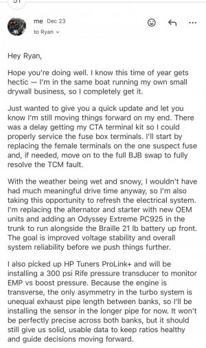

Pretty pumped for the next round of changes. HPtuners Prolink+ to monitor EMP:Boost pressure ratio. Rife 300 psi pressure sensor transducer. By monitoring drive pressure to boost pressure it will be crystal clear what healthy boost pressure is, and know exactly when the engine has had enough way before it ever becomes an issue.
Most OEM and stock-location turbo cars live with exhaust drive pressure well above boost pressure, often in the 1.6–2.0:1 range or higher, simply because of turbine and packaging limits. They work, but it’s inefficient and heat-heavy. With my setup, the hardware changes were made specifically to reduce turbine restriction and backpressure, so there’s no reason to accept OEM-level ratios anymore. For this car, a healthy window is roughly 1.1–1.3:1, 1.4:1 is still usable under harder pulls, and anything approaching 1.5:1 is a sign to stop adding boost and reassess. Tighter ratios let the engine breathe, keep temperatures under control, and allow timing and airflow to keep improving instead of hitting a wall…which is exactly why this system was built the way it was. Then it becomes easy to make informed decisions like buying larger turbines and swapping them in. No guessing. Data says what to do next.
No guessing and with the prolink+ it’ll be added to my VCM Scanner datalog parameters. I’ll be using a spare o2 bung post exhaust manifold, pre turbine. Since I already have that I’m going to use a m18x1.5 to 1/8NPT fitting, 1/8NPT 90 to -3AN. The sensor will get mounted on the firewall or near the strut tower in the engine bay with a snubber installed inline before the sensor so readings are smooth. I’ll be installing and wiring myself.
TurboGuard has a new product available for presale and I ordered (2) 3” Maxx Velocity guards to try out. My turbos eat ambient air so this will enhance spool and sound amazing. Later I can compare to my front mounted intakes with some Dragy pulls. Idea is to test them but bc of the added risk of debris I might hold them for track days only as part of a no limit prep. IMG 6990IMG 6991
Once I receive them in another week or so I’m going to send them to BPC Restoration in NY to powder coat them Illusion Purple like my motor.
I’m also stepping up my electrical system by adding an Odyssey Extreme PC925 battery in the trunk in conjunction with my Braille 21 pound battery remaining in the engine bay. My 16 year old (car was built in 09) alternator and starter are getting replaced with new units.
The dual-battery setup is for voltage stability, not just cranking. The rear Odyssey provides reserve capacity for high electrical demand while the front Braille keeps starting response immediate. Combined with a new alternator and starter, this removes voltage drop and electrical noise from the equation as loads increase, which helps sensor accuracy, ECU consistency, and overall reliability.
I’m getting ready to play with my CTA kit and get power restored to the TCM. At first I’ll just attempt to examine the female terminals and hopefully I can just replace those otherwise I’ll move on to the full BJB swap.
This car started out as a plan to build a really serious EcoBoost SHO… same basic mold, just stronger and capable of more. But the deeper it went, the clearer it became that it wasn’t playing by those rules anymore. Every time we tried to force it back into a familiar calibration, adding power only made things worse. It was like trying to jam an octagon into a round hole…no matter how hard you push, it’s never going to fit. At that point, the only smart move was to stop forcing it and hit reset. Now it’s in a phase where the data leads and the car tells us what it actually wants instead of us guessing. That’s why it evolved past surface-level tuning with SCT, and into HP Tuners….. because once the car went full-frame turbos moved out of the engine bay, a return-style fuel system with a dedicated fuel cell, and a fundamentally different airflow and pressure model, SCT simply doesn’t have the system-level access required to recalibrate something like this.
This isn’t about making it louder or faster right away… it’s about understanding it first. Because once you stop trying to make a car be what it isn’t, you can finally build it into what it’s meant to become.

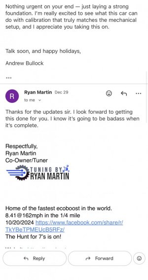

Update to share from Ryan Martin. I sent him an update and I heard back today. IMG 7217IMG 7218
Data driven ….data guarded. No assumptions, no vibes, no guessing. When the mechanical and software and tuning philosophy come together as one. Letting this Hybrid EcoBoost SHO reveal to Ryan what it is and what it wants. Truly exciting is an understatement.
The tool a lot of ppl like to dismiss bc they can’t argue technically, bc they can’t dismantle physics and fluid dynamics…AI. Such a valuable tool to use. Like whining someone used a calculator instead of count with their hands. Like saying online certificates and degrees earned don’t count bc they weren’t earned in a classroom. All that matters is if the information is correct yes or no. When a person(s) resort to attacking a tool they have already lost the debate. That’s the weakest angle to come from.

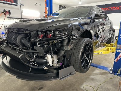

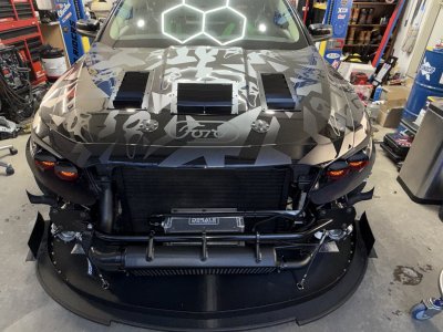

Waiting for my Maxx Velocity TurboGuards to show up. IMG 7199
Looks different with the intakes gone for now IMG 7194
