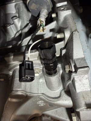

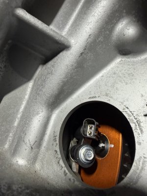

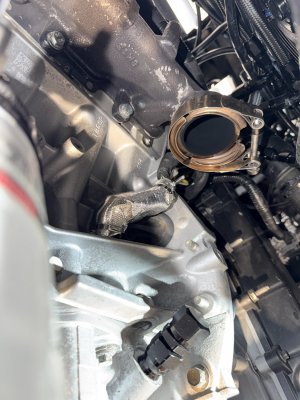

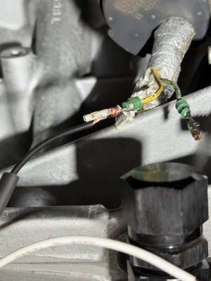

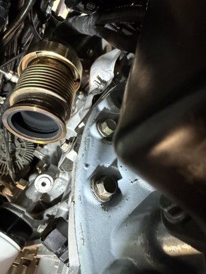

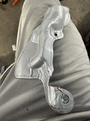

Test drive tomorrow. Fingers crossed the new CKP works! I added a rubber washer to the base of the bolt to help reduce vibration IMG 6705
I picked up a connector at O’Reillys supposed to be an ignition connector. Brought the sensor I took out with me and it fit perfectly. I didn’t have any butt connectors so I just stripped the wires back a little long, ran it through the pins and wrapped them around, then finished it off with heat shrink IMG 6728IMG 6729
After I did both I added DEI high heat loom and then DEI heat sleeve. New IPhone 17 pro max and some of these pics files are too big? That’s weird. Can’t upload the loom pics. You can see my front turbo oil return plug. IMG 6738
Then I notched a little bit of the heat shield.
IMG 6743IMG 6745
IMG 6754
Would certainly be nice if this gets me back to normal operation. Only one way to find out. Ryan emailed me and he wants a driving log and WOT blip

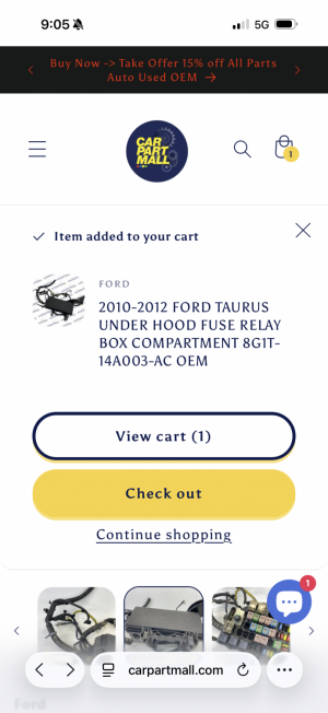

I said I have a donor BJB so I’m going to swap it out and I’m expecting to find my bus bar with visible issues. He agreed I’d likely find some corrosion.
Was nice to have him approve of my diagnosis and current plan to replace the BJB the fault is inside the bus bar. It’s not getting power from relay 53 and that’s within the BJB. It’s not post BJB in the transmission harness, that’s downstream from the fault.
