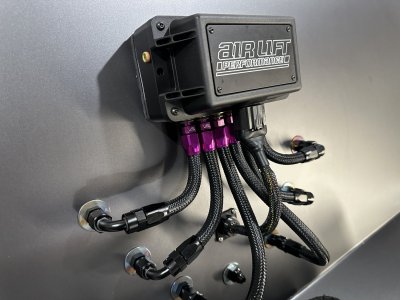

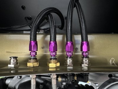

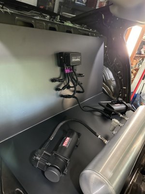

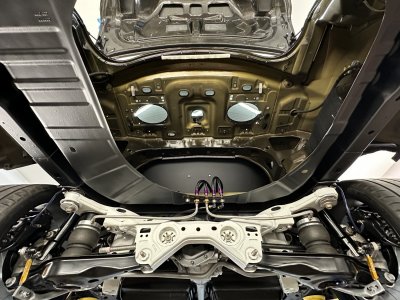

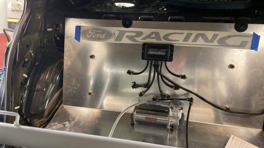

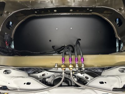

I’m not sure if you guys remember but a while back when I first started my air suspension install I had used my rear seat delete panel from @aaron240 to mount the tank and manifold. My cousin helped and we came up with this. IMG 6342IMG 6337

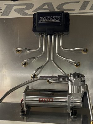

So many PTC bulkheads leaked……I guess every time a hard line was custom bent and test fitted to the PTC fitting…it was ruining the fitting. PTC (push to connect) are supposed to be reusable. These fittings turned out to be some of the most pathetic things I’ve ever used in my entire life. The worst was when I was trying to get the PTC cartridge on the Airlift manifold to seal in the tank connection and from putting it in and out repeatedly….(since all you can do is push it in) it ruined the rubber seal and air would blow right out of it. Airlift was nice enough to warranty the manifold but would not send me back an NPT manifold, they sent me another (new) PTC manifold.
So with the new manifold and being afraid of hurting the PTC (should stand for PATHETIC) I went to all plastic DOT lines to just get it operational so I could start adjusting my struts and fitment. My setup went from fancy to lame quickIMG 6522
So this layout on the rear seat delete panel was already drilled and getting a new seat delete panel was….something I was trying to avoid. Wasn’t sure what to do exactly with this……until…LevvelAir started selling anodized fittings that were PTC converted to AN (army navy) with soft rubber braided hoses….and I thought…this could work.
Well, it did! In fact, at a later date, I could convert my entire air system to all NPT to -6AN and only have PTC at the manifold itself. But for now I’m still using 1/4 NPT to 3/8 PTC on my front bags, and my rear bags are also 1/4 NPT to 3/8 PTC. So this I could convert and delete PTC and I will….but not right now. So this is the new setup that works!
IMG 1598

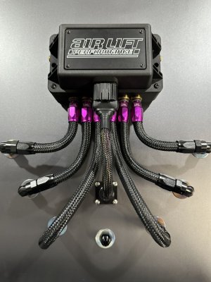

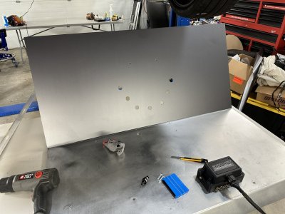

I stripped the panel and started vinyl wrapping it. I simply covered the holes on the sides that used to be for air speed control. I also ruined the rear of this ghost metallic dark grey trying to cut a piece….i cut through all layers of the roll…so after this piece for the top all I had left over were cut strips hahahaha! Damn! So the bottom is ghost matte metallic black and the back…but the front top is grey…IMG 1625

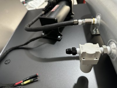

The PTC bulkheads were much larger than these -6AN bulkheads so I decided to use stainless steel washers that I drilled to fit the AN bulkheads and my son suggested I burn them with a blowtorch to make them sort of blue. IMG 1621
I also switched from one chrome compressor to 2 black compressors and was also able to convert the water trap tank feed fitting to -6AN as well. IMG 1622IMG 1618
So we got no PTC here except the manifold itself…I was tempted to not use the rear seat delete panel bc this setup with 2 compressors is heavy for what it is…I’d say about 50lbs total…including the panel…the panel is only like 8lbs so it was worth keeping as it just lets me have this nice presentation inside the car. Is what it is type of thing. IMG 1626

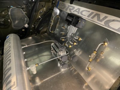

I laid down a thin rubber mat under the panel. Next was making the rear lines. IMG 1631IMG 1632IMG 1636
I then got one compressor going to get the bags aired up so I could put the car on the ground and open the doors all the way to run the second compressor wiring harness through the car and firewall. Success IMG 1630
No leaks!!! What a major accomplishment for myself to overcome these damn PTC fittings. Literally the LevvelAir conversion from PTC to -6AN saved my installation plans with the rear seat delete panel. Only thing left to do is finish the manifold empty hose line (dumps air out when you release air to lower the car) and bolt the panel down to the back seat. So basically done and on to the fuel cell!

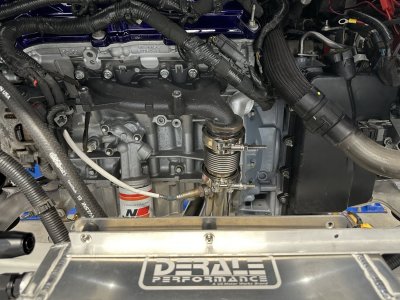

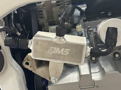

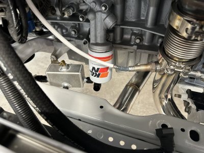

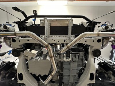

I’m not talking about the same type of system. For the turbos in a remote mount configuration, in my case in the front of the engine and below the oil pan…well barely below, I need to scavenge the oil return and need to use a pump. But it’s not that simple. In order to have a system that doesn’t lead to excessive oil consumption of the turbos you need to run the oil return into a sump tank, with filter.
After I made my post I sent an email to Turbowerx to ask about the location of my oil return dry sump, if it’s better to have it low near the turbos which bc of space means it would be off center, with the rear turbo (passenger front) having about 1’ of hose to the sump and the front turbo (driver front) having 3’ of hose to the sump, or if it would be better to have it more center with equal length hoses but at the cost of having it mounted well above the Turbos…using the scavenger pump…which would be better or does none of it matter bc of the power of the pump?
Let me divulge a little. The pump is Turbowerx “base-model” pump…but get this, it’s designed to scavenge hot turbocharger drain oil from anywhere to anywhere in automotive applications. Time-tested, proven reliability over years, and with its 1.75GPM (105GPH) scavenging capacity, it is powerful enough to scavenge oil from most twin turbo setups. It will self-prime/draw from over 8 vertical feet, and pump the oil as high as 20 vertical feet! Whether the application moves 1 oz of oil a minute or up to 1.75 gallons a minute, 'under-flow' applications are no problem. In fact, the TurboWerx pump may be run dry indefinitely. May be operated up to 60PSI pressure for pressure applications. It’s one **** of a pump! So it might not matter too much even though it’s less than ideal, that one oil drain hose is 3 times as long or if it was mounted above the turbos.
This is where I mocked it up, under the alternator. IMG 1690IMG 1689
It’s made for a twin turbo setup and comes out a single -8AN return with an inline 100 micron filter to the scavenger pump, back to the rear OEM turbo drain. I can’t mount it under the radiator inbetween the chassis splitter mounts, and I could do the driver side but it would be the same orientation, one side longer than the other. IMG 1691IMG 1692
I could mount it on the subframe closer to the center but not by much. As is I checked the oil filter, I can get it off and back on with the fitting directly below it. Or I could make some bracket to use the bolts that go on top of the exhaust manifold but that would put it higher but more center…but also hotter.
IMG 1693
1) will different length oil drains work just fine with the suction of this powerful pump
2) or is it more important the oil drains are the same length, more so than the height?
3) the different length oil drain hoses are insignificant and so is the height, the pump will easily pump the oil out of the turbos, into the sump and back into the block. Fluid flow won’t be compromised bc of an extra 2’ on one side.
I’m not concerned with the pump whatsoever. Just where to mount the sump. I’ve got over 1k into AN fittings and hoses, and it can take me up to 3-4 hours to make 6-8 hoses…learning as I go lol. I don’t want to waste anything so I need to decide on the location of the turbo oil sump and it’s basically done…feed, return, pump. Until then it’s on hold.

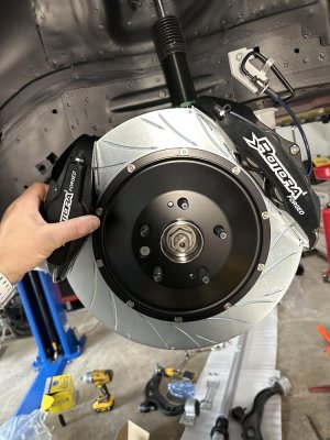

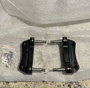

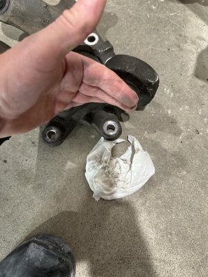

Today I got the new custom Rotora brackets for their forged 2 piston calipers I bought for my Voodoo13 hydraulic handbrake! IMG 1694
These are based directly off the same plane as the OEM knuckle caliper brackets. And would require 4 OEM caliper bolts. The idea is, to help make this setup easier to fabricate, will be to cut the caliper brackets off the old set of knuckles I haveIMG 1696
Then weld them on to the new knuckles at the same plane as the originals, then I can use OEM caliper bolts to bolt these new brackets to the knuckle and add the 2 piston calipers….IMG 1695
Rotora was kind enough to help out and make these brackets!

That’s a great article and man, a dry sump oil system is so RACE CAR!! That would be awesome!
This is where I mocked it up, under the alternator. View attachment 91192View attachment 91193
It’s made for a twin turbo setup and comes out a single -8AN return with an inline 100 micron filter to the scavenger pump, back to the rear OEM turbo drain. I can’t mount it under the radiator inbetween the chassis splitter mounts, and I could do the driver side but it would be the same orientation, one side longer than the other. View attachment 91194View attachment 91195
Today I got the new custom Rotora brackets for their forged 2 piston calipers I bought for my Voodoo13 hydraulic handbrake! View attachment 91198
These are based directly off the same plane as the OEM knuckle caliper brackets. And would require 4 OEM caliper bolts. The idea is, to help make this setup easier to fabricate, will be to cut the caliper brackets off the old set of knuckles I haveView attachment 91199
Then weld them on to the new knuckles at the same plane as the originals, then I can use OEM caliper bolts to bolt these new brackets to the knuckle and add the 2 piston calipers….View attachment 91200
That looks like a great place for your custom mount, based on your earlier pictures I was wondering where the f you would find space. Thanks for the education and product you are using. That looks like a great location near the turbos.

looking good. The fit and finish of the Rotora brakes and hardware is outstanding. No trimming needed of the rear knuckles and all hardware is supplied except you reuse your caliper bolts. And their line fittings fit right up to the OEM fittings. View attachment 90951
802SHO:
I also bought the Rotora calipers, front and rears, for my 2019 SHO PP. I haven't installed them yet because I thought we needed some kind of "spacer" and didn't know which one(s) were required. Is the Rotora kit as-delivered, plug-and play with my 2019 SHO; i.e., no spacers required? Thanks!
802SHO
Boost > VE, MBT, Cams
Oct 8, 2019
3,371
7,958
Essex Junction Vermont
802SHO:
The calipers are thicker so if you’re on OEM wheels you will likely need a spacer. Probably fine with aftermarket wheels. Can just put one wheel on gently, maybe put some painters tape on the side of the caliper….if your spokes of your wheel touch…then yeah, if they don’t then no. The Rotora kit is plug and play. Everything you need to install everything for the brakes is there. But if your OEM wheels touch then might need to get a 5mm spacer. Likely need spacers.
