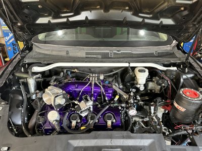

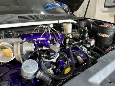

I decided on a place for my ProMeth methonal tank and made a small metal bracket, I’ll paint the bracket laterIMG 1877IMG 1878IMG 1879
I bought a visual fuel level I need to install on the tank and also the low level sensor and fittings/hoses but I’m taking full advantage of the extra space in the engine bay.

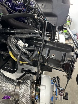

I rotated the center housing of each turbo for a more vertical oil inlet and oil outlet. I decided on and finalized the oil return hose locations the best I could, keeping in mind gravity, keeping the lines as low as possible, and avoiding the exhaustIMG 1845IMG 1846IMG 1848
It wasn’t my first choice but I learned I could run my front turbo oil return through the brackets of the chassis splitter and it doesn’t interfere at all with putting the splitter on or off. Everything near the exhaust is getting wrap around thermal protection (one more product to buy). Also will be wrapping the exhaust.

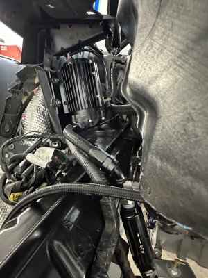

Decided on a place for the scavenger pump and then ran lines to it with the 100 micron filter, also doubling as a check valve I believe so upon shut off, oil doesn’t drain back into the sump tank. The oil scavenger pump company recommended I plug the vent to the oil sump to equalize flow since one hose is longer than the other. I’ll try that first and if it seems to have any issues I’ll just unplug the ventIMG 1862IMG 1863IMG 1865IMG 1864

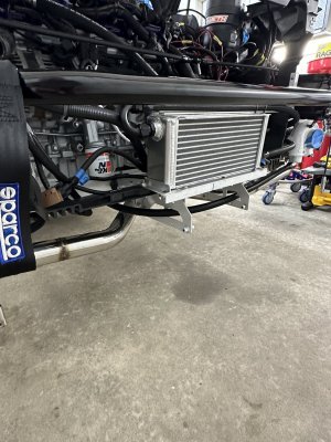

Trans cooler lines doneIMG 1871IMG 1872IMG 1873IMG 1869IMG 1874

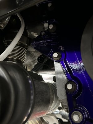

Waiting on new OEM rear turbo oil drain line to remake my return fitting to the block as it got damaged when installing the motor (hit something and bent). Once that’s done I can finish all lines for oil drain. Then install the meth pump. Then order a bunch of lines for meth and fuel cell. But I did finally get my XDI60 HPFP back from Xtreme-DI. They installed a 0 degree fuel inlet fitting for me for free (only had to wait 13 weeks). lol

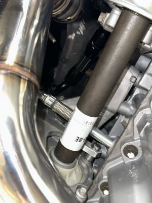

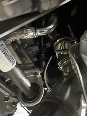

New rear turbo oil drain converted to AN. Was able to figure something out with a leftover 180 degree -10 fitting …comes out of the block towards the exhaust manifold and back around the side IMG 1891

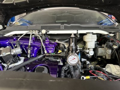

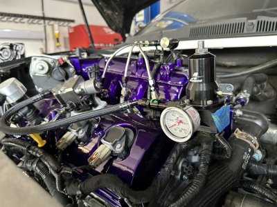

Lines are completely done, most connections are left loose bc I’m going to remove them to add the wrap around thermal protection. Made a bracket and decided on where to mount my Aeromotive fuel pressure regulator. Needs a brace and paint and done. XDI60 installedIMG 1883IMG 1888IMG 1889IMG 1887
Connecting dots is easier than deciding on mounting, that’s for sure.
