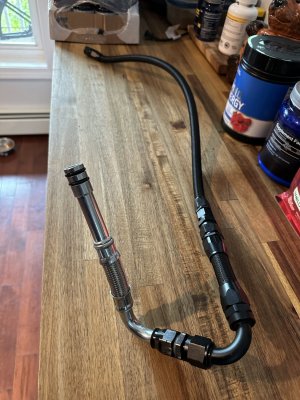

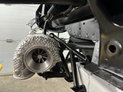

Here’s another look at the scavenger pump oil drain outlet -8AN to -10 AN 5/8 pipe compression fitting on OEM rear turbo oil drain to block location
IMG 2044

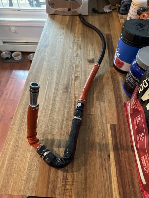

Now with thermal protection. -8 was the only size they had in orange thermal protection so it’s a mix match lol Image

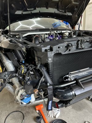

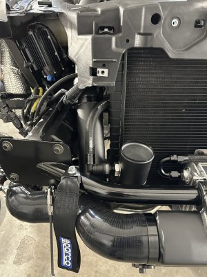

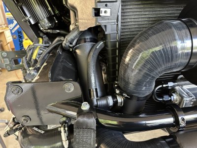

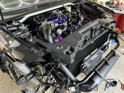

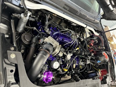

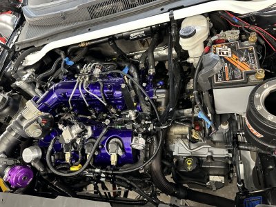

I’m working on the intakes and UPR dual valve catch can. I was able to run the supplied hose for our cars in UPR’s kit. I added a bung to the closest intake pipe. In this photo you can see how I connected to the oil cap then back in front to the passenger side intake pipe. IMG 2058
There’s a lot going on, I had to reposition everything a few times to get around the top radiator hose and figure out running that UPR line. This should work IMG 2059
I think bc it’s so adjustable as it was made from universal parts, it can take some time to get everything adjusted back to how I had it. Luckily it’s easy to see that it’s looking right or not based on how everything fits. There’s a weird order too so things need to come back off frequently as I dial all the positions in. lol!

Being at their shops in person they used my car for the measurements for 10-14' model years. Glad your parts all lined up. They were still looking for a local 15-19' to fit a system. That said they do use universal parts. They have boxes of parts for different models - they also use their own designed parts. Top shelf Continental hosing reinforced not to collapse.
The one sad thing my neighbor never got a chance to do was take measurements for a dual can clean and dirty side. Maybe I will reach out and schedule time to drop off for him.
I told him this platform is far from dead.
If you ever need more hosing or other sizing they will accommodate for sure.

I may need to reach out and move that pipe with bung to the other side. I won’t know until I get more of the intake connected. I try to make do with what I have first and go from there. At first I didn’t think it would work but I was able to come up with a way for it to work. Thank you for the info

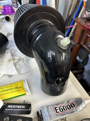

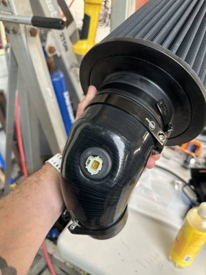

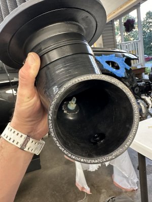

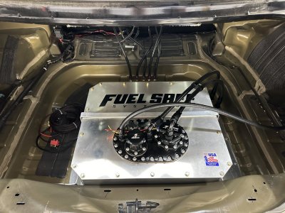

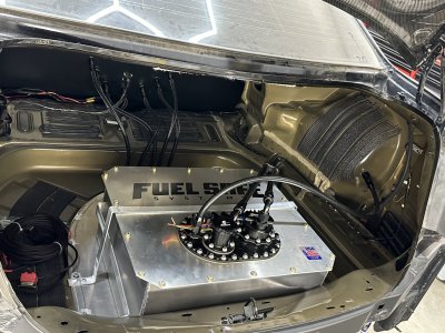

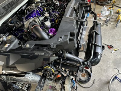

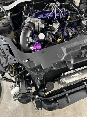

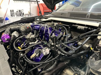

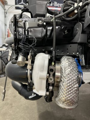

The to do list is getting shorter. Fuel lines are done, rollover vent is ran to the gas cap filler neck area with filter. IMG 2144IMG 2145IMG 2143
IMG 2119IMG 2117IMG 2120IMG 2121Intake is done and includes air temp sensor, cold air to solenoid and brake booster. Intercooler pipes are done and boost to solenoid, fuel regulator and meth controller. Just need to run wastage hoses and the OEM boost solenoid has everything like it did before. IMG 2152IMG 2151IMG 2149IMG 2124IMG 2131IMG 2129IMG 2139IMG 2140IMG 2154
Turbo everything is plugged and ran just need exhaust back onIMG 2147IMG 2146 Exhaust is getting painted black. Everything here IMG 2123
I got a 8 gang switch panel coming and exactly the harness I needed for 0-5v TPS signal for the in tank true variable speed controller on the pump. Pretty soon going to need all fluids in and bleed the brakes.
