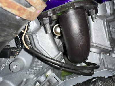

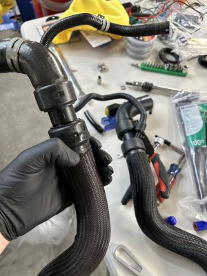

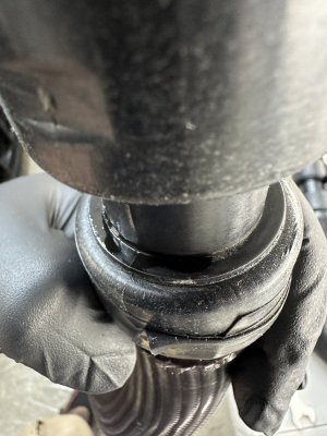

I’m chasing down a coolant leak. Thought maybe bc I blocked off the coolant feed and return bc I’m not water cooling the turbos that had something to do with it. I looped them and same result. I did find a bad upper coolant hose, the hard plastic connecting parts, weeping coolant. So, picking up a new upper hose from Ford after work and, going to pull the intake and address the seal to the lower coolant pipe. IMG 2270
I have no issues with anything else. Wild I have this leak but, I guess something is pinched or did I install a seal upside down or miss one? Other than this, it’s ready to drive! Starts right up now….but after having nothing in the car and it being just a shell….I’ll take it!

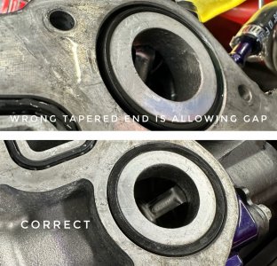

I’m an expert now. So I remember now I second guessed this…bc all the other seals protrude a little and this one is basically flush. I think bc the seal was new, having it the way I started the car with, it was protruding slightly like the air valves …but after tightening the bolts….not so much and big leak. That’s how you become a professional…making all the mistakes haha! Damn! Spoiled my fun…will be all set now. IMG 2276
Take away: Don’t second guess yourself haha
