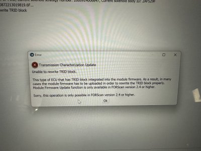

I just got this. Can’t program my 2014 trans to my 2010 car without V2.4 which I don’t see is even available to download IMG 2306
Texas Marauder
Jul 20, 2007
913
826
Lone Star State
Here is the link to version 2.4: https://forscan.org/download/ycu/FORScanSetup2.4.15.beta.exe
Just install it over the current version.

The TCM characterization update should only take a minute. Same with the RDU. However, if the vehicle voltage drops below 12 volts the process will freeze. Best to have a charger on the battery.

Downloading 2.4 now. One **** of a lifeline you just threw me. Thank you so much!

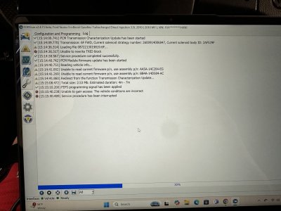

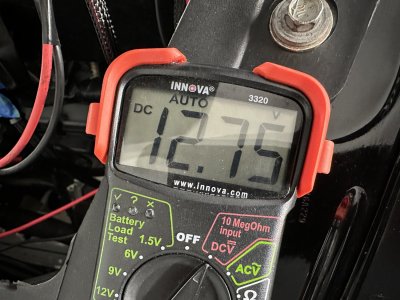

Still not working. Saying vehicle conditions not met. I’ve got v2.4. It’s recognizing OBDlink EX, laptop is ready to go, full battery and direct power, battery holds 12.7 with accessory on. Wtf is its problem? IMG 2309IMG 2310
I get to 30% every time and shut down.

The only clue I see is FEPS. Only the vLinker can supply FEPS voltage. FEPS voltage is 18 volts, IIRC. Another reason I prefer vLinker.

@802SHO keep in mind and I don't disagree with @Texas Marauder vLinker provides 18v, however Windows support to 10, not listed,11. You are gonna want to ask them if they have tested on 11. Also in their downloads, there is a firmware update.

FORScan works fine with Windows 11. FEPS voltage has nothing to do with vehicle battery or laptop computer. FEPS is a special programming voltage. It is created by the vLinker FS adapter.
Also, I'm assuming your PCM has the stock programming in it. If it has a custom tune you should go back to stock before trying to program anything into the PCM.
Programming using FEPS signal went away @2010-2012. I say again, if your PCM requires a FEPS signal you must use a vLinker FS cable or an original Ford VCM2. No OBDlink adapter will program a PCM requiring a FEPS signal.
Another option, if you have access to a higher end Autel or Launch scan tool you can probably use that to update the transmission characterization and RDU code.

I remember reading that your doors have to be closed so maybe the trunk being open is messing it up?
Sent from my SM-S918U using Tapatalk
That’s totally possible. Every time I’ve tried to flash with the hood open it quit at 30%.
Thank for this explanation - would explain why the OBDLink doesn't support it.
