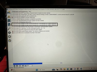

Without the stock calibration I believe you are stuck with what you got. I believe the TRID update is rewriting the entire PCM, not just the TRID. That is why you got the message highlighted in the picture below and why I suggested returning to stock calibration before updating the TRID. Newer PCMs that do not use FEPS only update the TRID and don't write anything else to the PCM. FORSCan support may be able to confirm this.

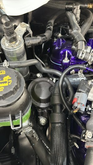

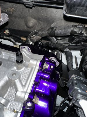

I sure will @Zpak but first I have to alleviate what I believe to be excessive crank case pressure. I took it out to bed in my brake pads and do a datalog. Actually decided to datalog the bed in procedure. 2 for 1 deal. Well I drove to my area and couldn’t start my log bc I didn’t connect the car (oops, it’s been a long time). I tried to then connect but it wasn’t working. I decided to drive passed my road I was going to use and pulled into a school parking lot to mess with the computer. Well don’t I smell burning oil. Pop the hood I have oil splattered in weird places. I remained calm, put the hood back down and B lined it straight home to my garage and lift. Couldn’t do the brakes or datalog. I get home and I’m thinking ok…uh scavenger pump? Rear oil feed plug? An oil line or fitting? Turns out…none of the above. How about just oil seeping passed seals all over IMG 2376IMG 2379IMG 2377IMG 2390IMG 2397
At first I was seeing what I thought must be VVT seal but the oil on other places made 0 sense until I cleaned my way to finding other spots and you know what? What causes oil to leak from the valve cover gasket seals? Excessive crank case pressure I’d say. G….I wonder what might be causing that UPR???? This F*^*%%cling valve cover breather plug supplied by UPRIMG 2398
I’d say I’m getting hot. This was never an issue for me when I installed their dual valve catch can back in 2018…but here we are, the motor is modified and I don’t think this plug should be here. Went 10 miles or so round trip so I don’t think there’s any real damage to seals I think I alleviate this pressure and all is good.

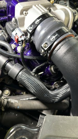

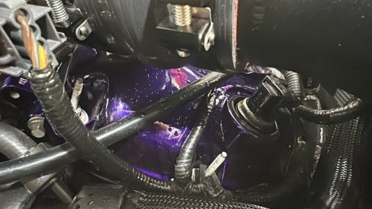

But then…..I don’t get it. So the intake manifold coolant pipe seal. It leaked right off the bat before. I redid it, good to go. After the long idles, after the short and moderate drive all good….im under the car searching for oil leaks, cleaning as I go. I look for coolant just bc….all good. I take a break and then 10-15 min later to out to look at the oil spots and I see an active puddle dripping on the ground of coolant. Like r u ******* I n g kidding me? Awesome. Throw my oil drain under it and go watch a show. What else can you do but laugh and have a drink and walk away. So anyway, idk if that’s related to excessive pressure but sure, why not, I’ll redo it again just for S H I TS and giggles. Bc I own a Ford lol it’s part of the deal I guess. I got a sweet set of tools bc of it and a lift! I’m a lifer not even 20 miles …sheesh IMG 2399

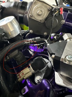

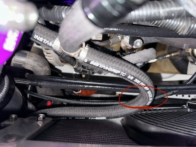

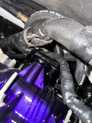

Wondering if it’s catch can related. Leaks are near hose attachments. Kit was T’ed at the oil cap to go to cold air reference over where intake supposed to be. That UPR oil cap is vented why the vent is plugged….but I rerouted that T line back to the left instead of the right and maybe it’s kinked….so under load from the engine it caused excessive crank case pressure. Next up is buy vent filter….coolant seal….and go home and pull the UPR reservoir and hoses and inspect for excessive oil….tracing steps back to “what’s different from last time” and that hose rerouted is. It’s likely kinked and that would make sense. I’m a mile a min here. Any insight appreciate as I troubleshoot my own theories in the interim

Hmmm right now I may just delete it temporarily. The hose did have a kink in it, the ID is 3/8 I believe and let’s say it was probably 1/8 ID kinked. IMG 2400
Now I’m having second thoughts on that smooth round gasket for the intake manifold I used. Which of these goes where? The one on the right would match the same seal design as every single other gasket …which leads me to believe this round one on the right goes on the manifold itself where does the smooth one go? Inside the pipe ******??? Which I don’t have anything installed on it now IMG 2402
The taper on the smooth one on the left would make sense if it sat at the opening of the ******, just inside the pipe??
