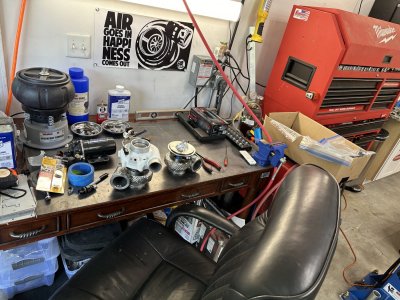

I am being left alone with lots of parts I wish I had. Think these will fit in my carry on?

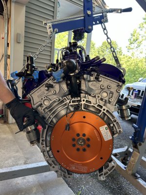

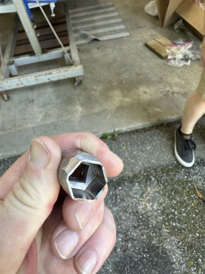

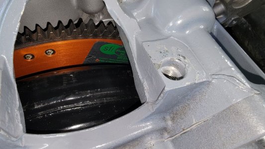

Had to grind down a socket to get the GH torque converter and billet flex plate connected View attachment 90998IMG 1548
Fit like a glove…barely but we got it!Image000000

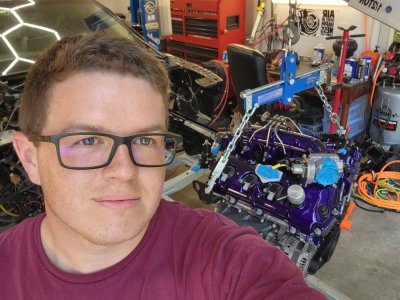

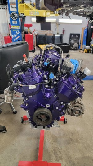

Obligatory engine selfie
1000009970
1000009950

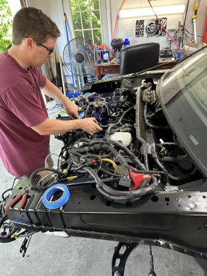

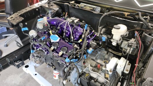

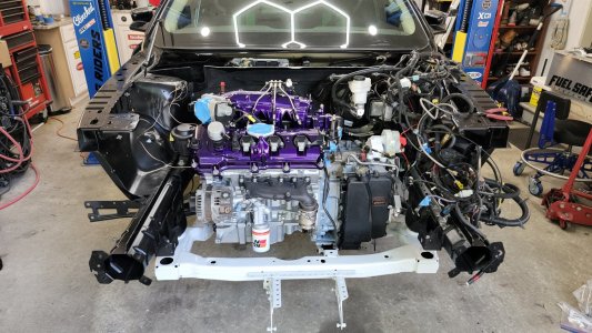

Fitted on the accessories and got things finalized for drop in. Lots of loose ends and double checking.
1000009975
Engine fought a little bit. The upgraded flex plate was a little bit thicker so the torque converter clearance wasn't what we'd hoped but we made it work.
1000009976
Engine in and harness being ran. Trying to devote a little time to wire management so we can have an overall cleaner look.
1000009982

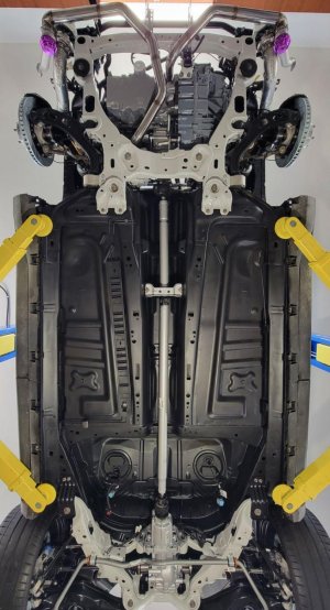

Front suspension, axles and brakes installed. These rotora rotors and calipers package is obscenely huge and look FANTASTIC!

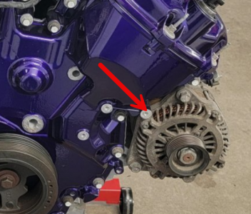

Not to be "that guy" but you spent so much time and money making a super car - the one stock part you kept was this?
1719423892936
802SHO
Boost > VE, MBT, Cams
Oct 8, 2019
3,371
7,959
Essex Junction Vermont
I was looking at nicer ones than that that you could choose the powder coat but the lead time was 2-3 weeks so …I’m just using what I got now but it’ll get swapped out soon, maybe sooner than later lol
Jordan_R
Sep 20, 2017
1,784
4,480
Missouri
@802SHO Stated his distaste for how raggedy it looked so don't give him too many ideas lol. I was making fun of him for trying to paint bolts up as we were going
