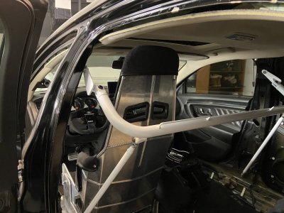

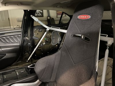

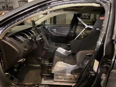

More interior fun. Got my Braum B-Pillar harness bar in. At some point I’ll get my Takata 4 point seat belt harness in. Picked up an Innovative Motorsports Ethanol gauge(with harness, fuel sensor) the OBDLinkMX+.

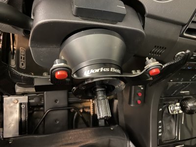

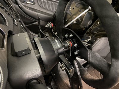

A while back when I removed my stock steering wheel with my cousin, I had him checking it out to verify he could wire up some aftermarket paddle shifters. He has been into robotics since he was about 15 years old. Now 21 he’s no stranger to wiring, let alone working on his own car projects. He’s always a great helping hand to have around. His take on wiring up another set of paddles was that it would be easy. Ok, let’s hope he can wire up this (Works Bell) universal paddle shifter kit with wiring harness to the existing harness that used to attach to the stock steering wheel. After the engine is finally in and everything is together and running (Just went for attempt 4 on fitting the turbos, still not quite in but getting closer) I’ll get my cousin back over and put him to the test, of which I’m sure he’ll ace. I’m going to challenge him to do a write up as well. So I should still retain M (manual) gear select with the aftermarket steering wheel.
Real Carbon Fiber, pricey too so let’s hope he can deliver! 92133D50 E3C5 4132 80D5 98F78C9058FFB21FC8EC 2BAF 4594 A9C4 FEF33ABE1B18622C0466 2057 475E BA78 BA01A05952BB0A18BC9F 1FDE 4F48 8457 D648FB59439D414D6449 618D 4640 B472 A8AF630F0CC6C4A7E38E 10AF 4F7B AF5D D02BE041D19D4C40F023 9E74 49AE 9570 1CEB9F7F925828B01BA7 59A0 4AE2 B0A8 4502D6F15E81CDC55553 7CA3 4DFE A29D C0F5472FB09080D001DE 075C 4E66 ACEB 171E12C80C89

Very cool! I'm not seeing a lever on the paddles, is it activated by the buttons is there a hidden lever mechanism for shifting?

Wiring is inside the housing, that’s why it’s so thick, coming from each end and meet in the middle, and all wires are hidden bc the Sparco quick release is installed on top.
