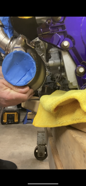

First look at the G25-550’s mocked up. View attachment 83621View attachment 83622
This is going to take some finesse….stay tuned!

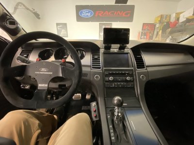

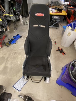

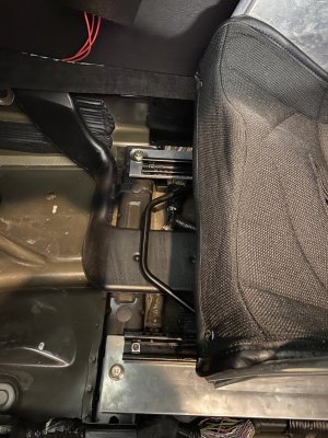

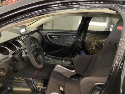

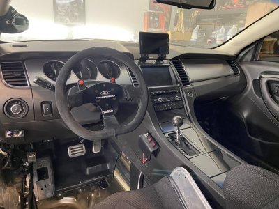

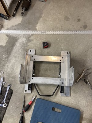

Some interior updates and progress. Aside from adding back my front door cards, I was able to get my Schwartz Engineered Performance new seat brackets and Kirky seat with Sparco sliders installed. Before I was stationary and once bolted it was where it was….now I can slide it back. So nice! FED04DF2 2658 4213 97B6 F55F714A2430C6974BA5 5F46 48B5 8682 4DE2B64AA366AA5FCF5D 6312 4A0A 9FB8 6F8A1B430EE9

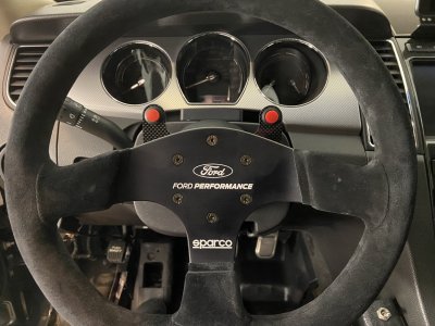

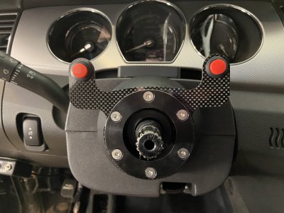

I also will be removing my nitrous controls from the 3m tape attached to the side of the shift column to these steering buttons8AE58B9A 375B 4498 A9C1 C044C06C9D140EC5E001 729D 47D2 A680 16AFB0AC2621

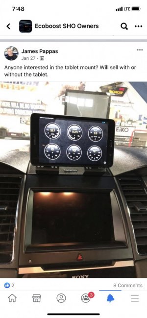

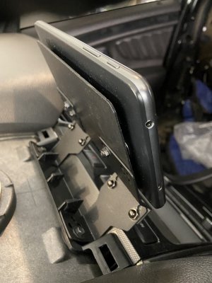

I’ve always wanted one of those 3 gauge pods to replace the main Sony Dash speaker bc I absolutely love that look. But I ended up buying this tablet setup with brackets a fellow SHO owner listed for sale in one of the EcoBoost SHO FaceBook groups, a little over a year ago. It attaches very slick to the inside of the center Sony dash speaker and it’s going to be my Torque Pro gauge display of 6 digital gauges running directly off the OBD2 port.52964FB7 7E91 446F 82CB 5BEDB3ECF002
CF3BBFDB 51F7 4DBD 9CD7 3E134E398A0129315C0F 6BB5 41D9 B953 9A8FA8B813804C7070F0 842D 4964 929D E2BDEE7E1304
Once it’s up and running, I’ll need to hide the wire in the dash and get a black cord (came with white) so it blends in better. It’s going to look like this all said and done and what I think is a really cool alternative to the current 3 gauge pod available. Picture below on what sold me.

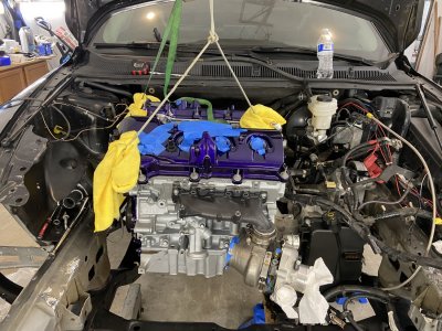

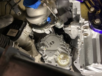

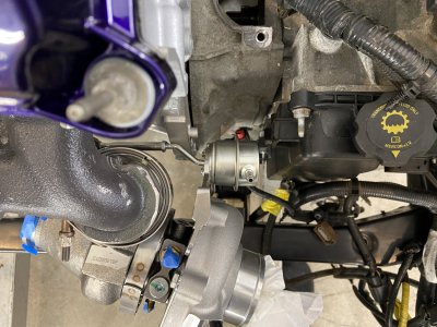

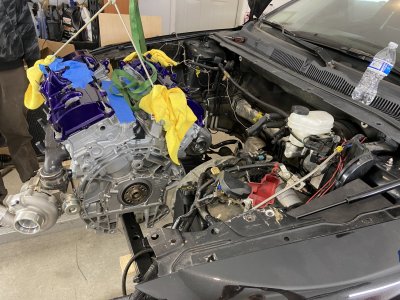

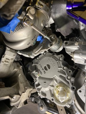

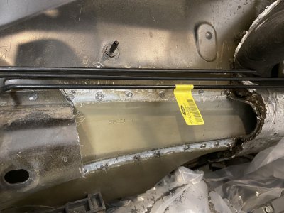

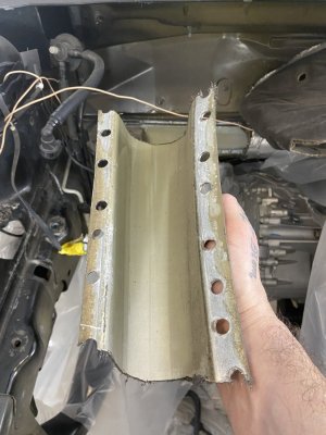

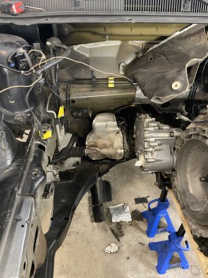

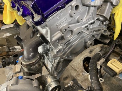

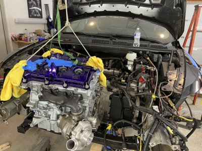

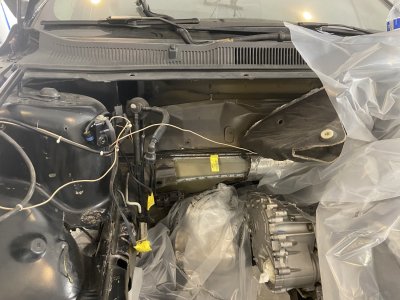

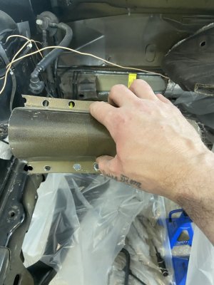

Test Fit #2. Closer but steering rack not cooperating. Next thing to try is adding pie cuts to the rear manifold, to bring the rear turbo down, in, and angled slightly back up at an angle. 0F740383 E7FA 452B 8E5F 0DC8E3038D9C267CB61A C803 44DD A6B9 E05530B156450E4C3E97 A730 4263 B154 809E18B8B13D34F71996 C66E 4CA2 A8E3 B1996D9E8AF9653BDB6C 1285 4B6E 8522 1521E202CFA6

Can you remove the TC and see what the space looks like after you drop the engine down to where it needs to be? It might give you a better idea of what you need to do.
802SHO
Boost > VE, MBT, Cams
Oct 8, 2019
3,371
7,957
Essex Junction Vermont
Any chance that the transmission is drooping slightly?
It’s actually supported bc without axles in and connected to control arms/suspension it has nearly no bracing and with weight of PTU needed extra bracing under. So it’s good
