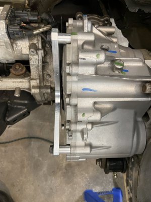

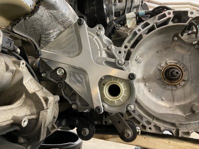

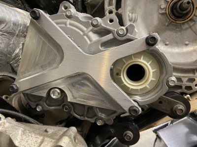

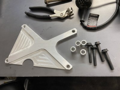

Some exciting things to talk about. Received my Schwartz Engineered PTU brace today. It’s made from one solid piece of billet aluminum, can’t be more than 1lb. Has some heat shields to mitigate cooking the fluid. 19866D87 5AAB 4CC7 8BBE 5919A23DEBFB
Fitment is perfect 27C96376 089D 4797 9515 15CCFCFB91395C8CAA88 C650 4E42 8DC1 4CE797518BD3CB8CFC00 2F69 4EEA 805E FBB1A7E1A256
The passenger side axle is going to see some stress for sure with the Traction Concepts LSD conversion and this brace is an excellent match! Contact Aaron240 for more info!

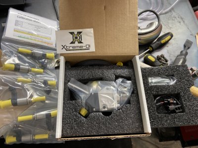

Also received my XDI 2000cc injectors back from being flow tested and getting new seals. I sent my XDI60 along for the ride to get checked out too, both came back in new packaging and are ready to go! $270 from Xtreme-DI, feel free to reach out to them for all your fueling needs or to have anything flow tested! And btw, Uwe is pronounced Oova. Blew my mind. Lol! But now we can all pronounce his name correctly.A8E3C0EE 31DB 4E2E 9E81 C483AAF5CF5F

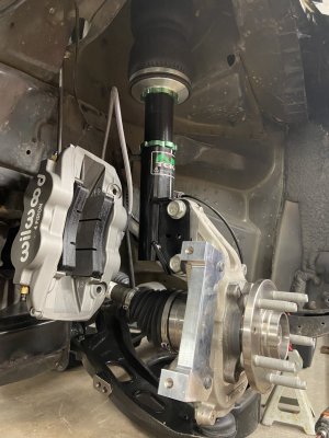

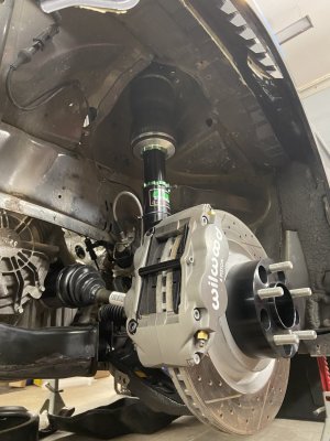

I decided to get new axles for the front, thinking I might snap one with the TC lsd in the front….then thought I might as well should start off with the new ones and if they snap I’ll have the originals as a quick replacement backup. So in the front is new axles, new 13+ steering knuckles with Timken wheel bearings, new front lower control arms, Airtekk air struts, Jordan’s 13 R1 Concepts Rotors, Aaron’s Wilwood kit. Need to run air lines for the front struts. 9BB2EBF3 7BE4 4D84 A4B0 E2A3F91117F6104B583C 9462 4101 861E 061F4805DC85

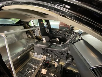

And then I’ll start installing my Airlift compressor/tank and management to Aaron’s aluminum backseat delete panel 0FA9D15E 48E7 4610 885C E225FDF366E9

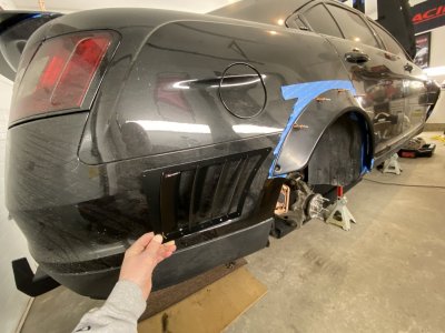

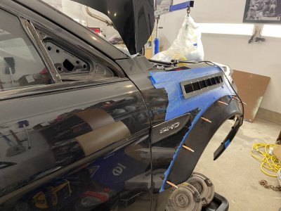

And then give this thing some power to make it go up and down. And then finalize the fender flares and vents. 265D31AA CADD 4085 9CC6 D4A3CC9DFFB11A853FDD C681 471E 9F14 B2285F7416880D2CE208 1787 4920 8096 01D92463A07FPush it outside and put the front bumper on…..and get a glimpse of what the **** this thing is…….then I’m expecting to be so excited I’ll want to give it all I’ve got to get the motor in and get it running! 8BEFA9C9 6517 4D1B B857 DCE19CBA9B91

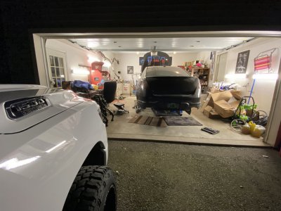

So, GF was away on a business trip so I was given full access to all hours of the night to make as much noise as I want. E3CFBB4C 3540 47EC AEC9 21A20D935BCE

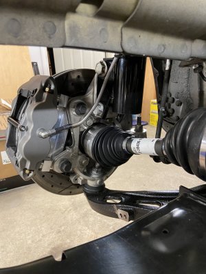

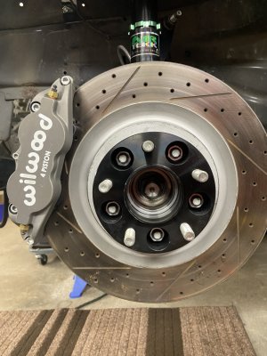

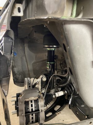

Passenger side axle, knuckle, wheel bearing, suspension and brakes on. Shiny stuff 9C77ECAD 593E 4502 A58C 9F8994E5C3B4FB013253 7F44 4D2B 9442 588244E35B0D

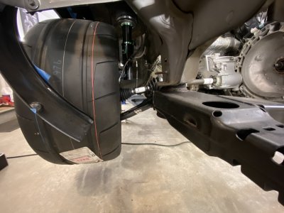

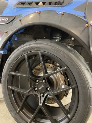

Had to put one wheel on and damn is it thicc 607F9D2D 746D 4D68 8968 3250E92CF7DE0EECC5FE 7412 47BD BDA9 B207E68C4E50

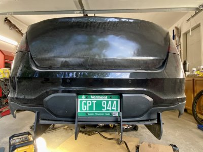

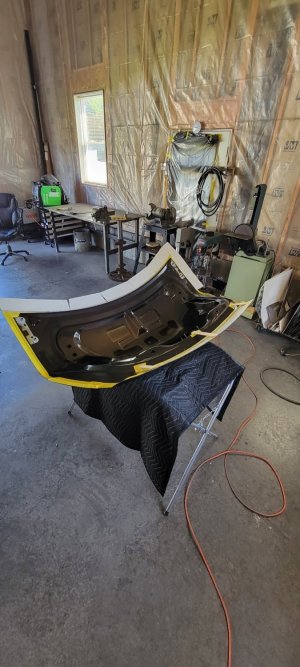

I did receive a CF trunk from Aaron and it certainly is lightweight and serves that WR purpose.BF1038BA E333 4F2A 8B4C A091A7BC83C3

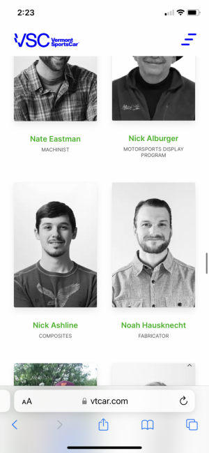

I decided to take it a step further, I now have Nick Ashline, from VSC (Vermont Sportscar) the company that builds the USA Subaru Rally Cars, I know everyone knows Travis Pastrana? 35D9AD7E FF37 4489 B2A4 1FA90AA58B0B
Nick does composites for VSC and he has my OEM trunk and 1k deposit and he is working on making a beautiful piece to also have some sort of a spoiler/wing. Can’t wait to show you how that turns out! Nick is hoping to have it come in about 2k said and done but I said it is what it is. So I’ll be paying at least another 1k when it’s done. But it should look absolutely amazing and I can’t wait to see what else Nick can make for me. Here he is gluing flanges on getting it ready. CE8E9A94 22B9 498C A44E F7BF1263196713BB5CA3 B119 4985 906D 4BD2E3738F58

Dang that tire is thick! Who needs the track when you bring the track with you hahaha. Brakes and everything look good. That CF stuff should offset a decent amount of weight I’d imagine.
