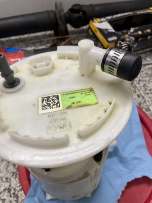

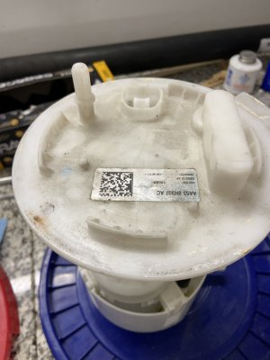

In tank fuel bucket swap 2010 to 2013+. Something I wanted to take care of before setting and forgetting my new back seat delete with AirLift management panel.
2010 OEM in-tank fuel bucket with DW300C LPFP : Note the top closed off vent
A38AAD80 5D9E 429D 8A20 FF1DE2F4C6FD
2013+ OEM in-tank fuel bucket modified to accept the Walbro 525 LPFP :Note the open vent now blocked off.
875FFFA1 365F 452A 9FFB C95A1B036144

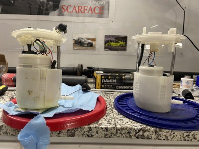

Side by side 2013+ left to 2010 right E9D21C66 7ADC 4CDA 9B34 C23DFD897197
Right off the bat, I was not expecting to see the open vent change on the 2013+.
Clearly that plugs into something, however on my 2010 there’s nothing to plug it into. Both the 2010 and 2013+ have an inside snout, just the 2010 is closed off and basically returns back inside where the 2013+ attaches to something else. Since the 2010 is a return loop I’m not sure what it needs to do, essentially it is blocked off so I just went ahead and blocked off the 2013+ with a fuel line cap. This should be fine???

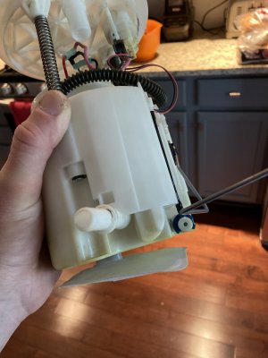

Max Power Automotive installed the Walbro 525 LPFP in the 2013+. With the advice of a fueling professional (to prevent fuel starvation) he installed the filter on the outside of the bucket.FC7E2051 C612 41EA ADF7 FD65A9CE18B3
Originally I had sent him a new 2010 unit but he said it wouldn’t work, now if you go back up and look at the differences from the 2013+ and 2010, you can see the 2010 is much smaller and must be why it’s a matter of physical space. So I rolled the dice and hoped the 2013+ would still work, simply plug in and it does except the different top vent. Anyone know why this might be an issue for me to cap it, seeing as how the 2010 didn’t vent outside to begin with?

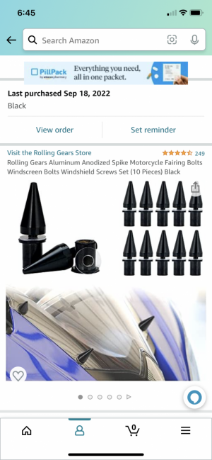

I have been staring at my Cleco pins holding my fender flares on and I kind of like it lmfao! D718B130 7D00 4CF9 B5CB 4784CA5DB84D
So I am going to use these spiked hardware for motorcycles haha! I think it’ll look sick 5040A404 6B60 4189 ACCE 1691C3EA7E6C

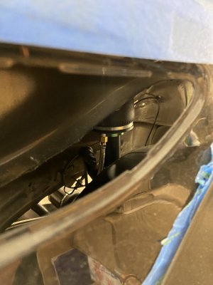

Other than running wires for the AirLift management through my firewall, I also bought an AirLift controller mount, specifically for an Audi R8. It’s basically just a side bracket and I’ll mount it to the right of the center console. Funny, Bag Riders must think I have an R8 LOL.

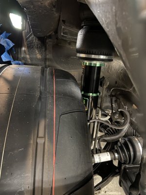

I may need to get a custom set of wheel spacers made, my 2” might not cut it. Think I may want 2.25” or 2.5”. We’ll
Find out. It’s only like 1.5” side clearance from the strut. Ultimately I don’t care how close it is as long as it doesn’t rub but…idk lol. DA3BB318 4E15 4261 86A5 9F0BDFDBA193C0E95680 2FBD 4C08 91DD E621510DEE64

If you still run into any clearance issues with your strut you can swap out your double bellow bag for a slim double bellow, that’s what I run on my flex with no spacers
My wheel offset of +45mm is the main problem. Plus a 315 wide tire. Good to know about a different bag. The bag seems fine for now. I need spacers anyway for the flares.

Last night I got the fill valve and relief valve connected. I’ll convert that to a hard line later. I’m going to actually cut the harness and turn it into a plug and play for the manifold and compressor connections, so I can keep the seat delete panel portion nearly untouched if I need to temporarily take it out/put back in. Also want to apply the vinyl and stickers. That last 5% is all cosmetic and practical use………essentially it’s ready for a test now. Just need to put the panel back in, connect the wires, harness and run the plastic lines from trunk to back of seat delete and I can hook it right up to my battery.

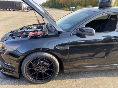

Last night I did the first test. First thing I did was forgot to put the tank line on from the compressor to the manifold so it was just blowing out of the tank as the compressor filled it lol! I took that hard line off so I could flex or compress the seat delete panel inward to get it in the car. And forgot to put it back on.
Second thing was one hard line was audibly leaking to a bulkhead so we emptied the system and bent it in a more favorable position to seat properly. Then audibly you couldn’t hear anything, but could see bags would very very slowly…really slowly lose a psi every min or so. Started the soapy water spray bottle on all the threaded fittings. Some with another 1/4 turn were fine, there was one however that we ended up tightening to a level of concern, and stopped, decided to start reading some (directions) which were included. Hahah! Why is we we try to do so much without any help, then look for help only if we have a problem….when we would probably have no issues if we just read them BEFOREHAND!!
So the wicked wicked slow leaks are at my Teflon taped threads, and hard line to bulkhead connections. All of the plastic lines do not leak in any of the push to connects and also any threads supplied that already had a thread sealant are also not leaking. So what is the issue? After reading the directions (very humbling) it’s recommended to triple wrap threads with Teflon and under some applications even 7 layers of Teflon. I only covered the threads with a single layer with a tiny portion overlapping. So I will unthread all of my Teflon wrapped threads and rewrap them with 3 layers of Teflon tape. I think that will do the trick for those ones. On the hard line connections, they weren’t too bad but we did not deburr the ends at all….that HAS to be the issue. They don’t have big chunks or anything but since we are going for air tight, tiny debris not allowing a perfect seal is the problem. I’ll be picking up a deburring tool as we speak.
Other than that, the compressor wasn’t that loud. Let me explain, it was sort of loud, loud as in it is a noise, but for a compressor, it was quiet, if that makes sense? And we went to about 140 psi in the system/tank and 65-66 psi in each bag, all the air sounds adding or taking air out of them was surprisingly music to my ears………so far I can assure you that it’s beyond what you imagine for being cool……like I assumed it was cool…..but first hand experience it seems A LOT cooler than I expected. Idk how I’ll ever want to NOT have air suspension lol! Like getting a tune for your SHO…you’re immediate thought is….why did I wait so long…..same feeling for me with the air suspension.
I didn’t take it off jack stands, no point in taking it off if the system can’t self sustain (leak). As soon as it’s stable with no leaks it’ll get put on the ground.

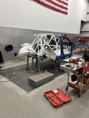

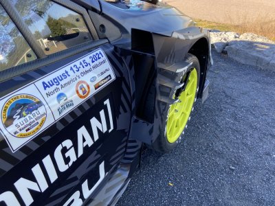

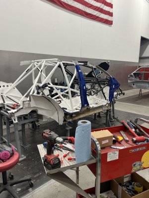

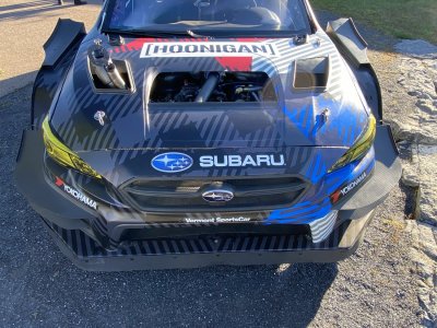

Ben Ashline from VSC invited me to check out their facility as they were doing a cars and coffee this am. I’m beyond impressed. Their facility is state of the art, can only guess how many millions of dollars to build that place. I only saw a tiny portion of it. I’m even more impressed seeing it in person and even more excited to have Ben and Nick Ashline working on my Taurus. 0920AC6B 6E40 4AEA AFAD A3DA464F6C3A2F7762E7 8950 4DEF 8135 6608AD76BE50A96397C6 0FE5 440C B9FE D61978592609
And they also had Travis’ Gymkhana car outside. Everything looks more impressive in person. 4E52F47F 536E 47E5 A504 FAC1046BA2D1988727B8 2153 41A5 B2A9 1D358F4C1380D5ADCAD1 AA2A 4FF1 BD46 6FD3150A1ACC044D35A5 1C0B 45BF 800D 0C7149424A004D95C6BD 9832 4DC3 AFCA E20F0E836113
This rear bumper opening with that STI radiator or whatever cooler that is….it’s actually like 2-3ft deep, it looks flat in the picture but it’s very “active”. The active aero on this car is how it’s able to steer/fly in the air and not crash 87C00902 588D 48CC 81ED DC142A033213
