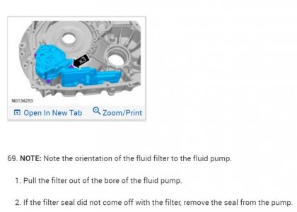

No, the Filter is one of the last steps after halving the case and pulling everything else out of the way to get to it. as shown as step 69....
802SHO,
After watching the filter change and the module change in your video I'm wondering. Would you think it's possible to replace that filter while the transmission is in the vehicle?
Thanks
Frank

I'm a newbee when it comes to transmissions. Are you saying it has more than 1 filter?
Frank
It really has one filter the main transmission filter. The other little tiny thing attached to the valve body is a filter plate but not anything in comparison to what the main filter is.
