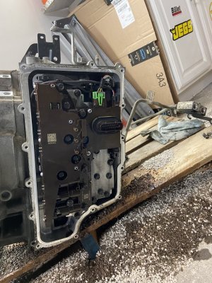

I have successfully swapped “brains” in the two transmissions I have. My 2014 junk yard trans now identifies as my 2010 lol! With the help of @Autox4fun he advised me I could just swap the solenoids and not have to take my vehicle to Ford. He also gave me a part number for replacing the filter plate when performing the swap. I ordered them directly from https://www.wittrans.com/. Part number 25016A. $34 dollars roughly.
It was a first for me and just in case anyone else might want to do this I filmed the whole thing. Video coming soon. 43D0342E FA18 4713 A31A BD35DFBF14E1

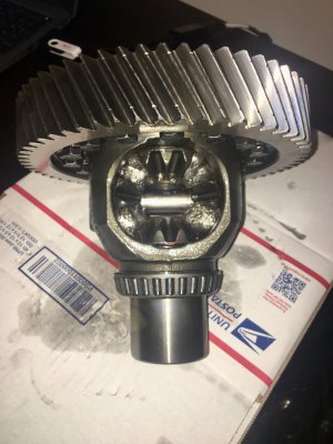

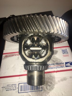

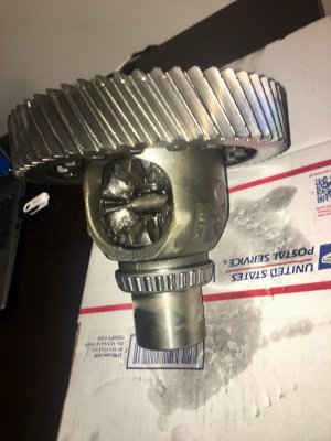

Happy New Year!!! 2022 is going to be interesting. I present to you my Welded Front Diff! 4939DB7E B1A5 4005 9A31 1E369729F6969CA088F1 F954 4503 A5F6 BD221E8E79A997B1A823 79E5 4C85 9830 DDBAB31EF4A3
@aaron240 and I made a deal to start working on a phantom lsd grip locker for our particular front diff, as to be modeled after the design by Racing Diffs, however the space was far too tight. We didn’t want to have to modify any teeth and that would end up being the ONLY way to get something in there. Only 1” between the gears.
Scratching that idea, Aaron reached out to 5-6 companies about making a one off custom LSD unit. A few companies got back to us but they wanted 30-50k upfront and a 20-30 unit group buy. So, I told Aaron to have it welded and he was able to provide that service. It’s welded in 4 spots on each side so 8 welds total. Using high quality materials and it really looks good! And it’s been hot tanked to ensure there isn’t any debris from welding.
For what I have into my junk yard trans, Im willing to use this welded front diff to show everyone the benefits of what an LSD could offer….without breaking the bank. Of course this isn’t a limited slip unit, it’s now locked but….in a straight line should provide results as to what a limited slip could do if an LSD for our platform existed.
If I can prove that this can give another 1/10 faster 60ft at least…….then maybe 30-40 ppl will stand behind a group buy of a real LSD.
My New Year’s Resolution is a 1.4 60 FT!
FrankK
Nov 8, 2021
212
217
Colorado Springs, Co
802SHO,
My first thought was why would you want to weld that differential. After reading the post I understand, but I'm thinking it may be an issue when you are making turns. Let us know how it turns out.
Frank
802SHO
Boost > VE, MBT, Cams
Oct 8, 2019
3,371
7,958
Essex Junction Vermont
802SHO,
Frank
I wondering how this will be able to turn?
Turning sharp will cause one wheel to drag intermittently and cause uneven tire wear. Depends on how much sharp turning I need I to do the tires will wear fast. I don’t look forward to sharp turns but I’m optimistic I will be able to live with it.
This is a test. I’m willing to sacrifice a transmission, front axles and any other weakest link. To hopefully show:
1) the performance benefits of what an LSD could do
2) hopefully have no failures
3) remove and inspect the front diff and welds when I swap in the other trans I plan to build
4) hopefully show that turning isn’t as bad as we thought
5) if it is working great it’ll go into my built trans.
7,441
9,749
If you have a softer tire on the front, it will help with the turning.

802SHO,
After watching the filter change and the module change in your video I'm wondering. Would you think it's possible to replace that filter while the transmission is in the vehicle?
Thanks
Frank
802SHO
Oct 8, 2019
3,371
7,958
802SHO,
Thanks
Frank
Yeah but it would make a huge mess. Only 5-6 quarts come out when you drain the trans. Taking the side cover off in the car could be done.
