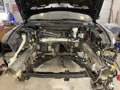

I’ve made a little progress. Picked up the new trans and rdu out of the 2014 SHO with 61k. 23F155D8 2E6E 4809 85A6 8E5404EB6BE8

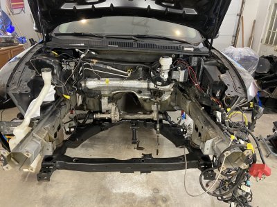

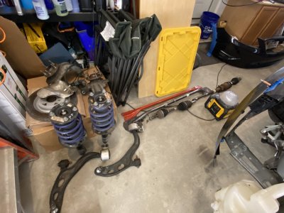

Now to remove my trans it went really well, first I had to remove front brakes, control arms, knuckles, axles, struts, strut tower brace and ptu. 549B12A7 7287 4F98 A397 F18B67133963
My ptu has been leaking passed the seal for a minute! Quite the mess to clean up afterward in the engine bay. F1D5A6DB CB67 47BC 8F7F D1AB798647B1

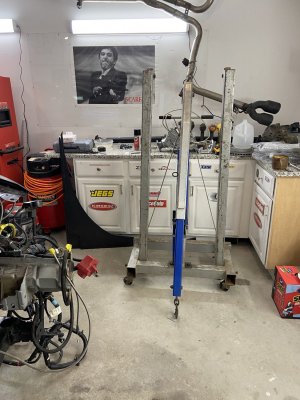

I borrowed my friends cherry picker and snagged a pallet from O’Reillys, cut it down to a smaller size to put my trans on. C85F9318 E157 45FD AD84 4CB1BC1A3F78

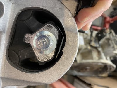

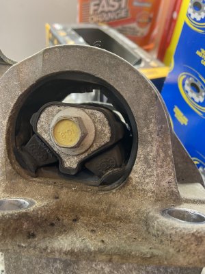

It came out pretty easy, I left the top trans mount attached to the trans and used it to attach chains. Which btw my top trans mount is beat! As you can see compared to a new one….of course looking at the new one…hmmm maybe I should fill it all in?4133CCD9 49A8 477D A3E8 9086A56A193B0285413E E36B 4EFD 85F5 A46380BF9044

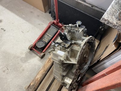

Once I got my transmission out I was able to just rest it on the pallet and slide it out of the way. 8536F3E7 DA61 4C9E B1A7 8B6F12E83FE8
So before I do anything else I figured I should clean it up a bit. I put some plastic down, went through almost a whole Purple Power spray bottle, then actually grabbed a little steamer I have and it came out pretty good. Before.A8050C44 A07A 4270 97C3 533B1011FCE6
After. 6810F121 9B7D 4056 ABDD 0009D4CC4B8F

Everything is looking good! How do those LCA’s look while they are out. Snapped a bushing on mine the other day, doh!
They were actually fine but I stripped one end last year on the driver side so I wasn’t sure I’d get it off the knuckle, since I had to remove the control arm from the subframe last time. So I just bought two new ones since I just got two new 13+ knuckles to fit the front Airtekk struts.

I’ve made a little progress. Picked up the new trans and rdu out of the 2014 SHO with 61k. View attachment 82595
Now to remove my trans it went really well, first I had to remove front brakes, control arms, knuckles, axles, struts, strut tower brace and ptu. View attachment 82596
My ptu has been leaking passed the seal for a minute! Quite the mess to clean up afterward in the engine bay. View attachment 82597
I borrowed my friends cherry picker and snagged a pallet from O’Reillys, cut it down to a smaller size to put my trans on. View attachment 82598
It came out pretty easy, I left the top trans mount attached to the trans and used it to attach chains. Which btw my top trans mount is beat! As you can see compared to a new one….of course looking at the new one…hmmm maybe I should fill it all in?View attachment 82600View attachment 82599
Once I got my transmission out I was able to just rest it on the pallet and slide it out of the way. View attachment 82601
So before I do anything else I figured I should clean it up a bit. I put some plastic down, went through almost a whole Purple Power spray bottle, then actually grabbed a little steamer I have and it came out pretty good. Before.View attachment 82602
After. View attachment 82603
